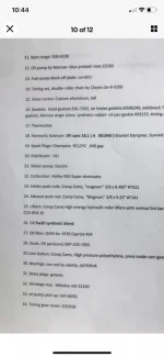

  • My theory is the galley downstream of the pump is blocked. How could this happen?
