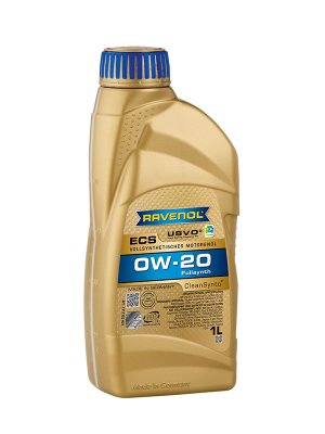

Personally I'd prefer using some product which provides
official STJLR.51.5122 approval along with MB229.71, BMW
LL-17 FE+ or even VW 508 00/Porsche C20. Preferably true
approvals again.
One example (perhaps one of the best available next to M1):
https://www.ravenol.de/en/product/motorenoel/pkw-motorenoel/ravenol-eco-synth-ecs-sae-0w-20
If they matter (I think they do) their specs are mind-blowing.

I saw the Ravenol oil too... Again never heard of it, and never heard anybody talk about it. I do note the JLR Spec is approved... So that's something. I attached the Product Data for the Ravenol too... Looks pretty similar to the Castrol Edge Professional E which is the OEM recommended. And I like that Ravenol listed the type of ASTM test they used to get their numbers (not that I know the difference in tests, but it lends some credibility... Unlike the Valvoline)
Just to be clear you don’t approve a spec, you meet it. There are no specification approvals.
If you’re dead set on a 20-grade then picking one with VW 508 00 approval is one of the best.
