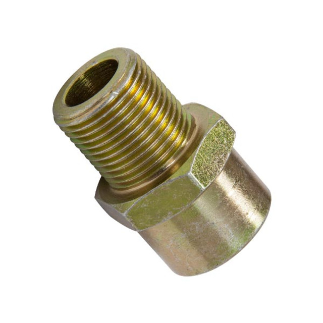

Hello, I hope this is an acceptable place for this question. I have been looking to no avail on a sandwich oil cooler/warmer for a FL1a sized filter. looking for something along the lines of what is in the attached photo. 13/16-16 thread. all the ones I have found are m22x1.5

You should be able to take that nipple out and replace it with what you want. The oil cooler sandwich plates and gauge adapters come with a variety of nipples with different threads on the end.

Pretty sure they are a standard length. If you get a remote filter adapter they usually come with 4 or 5 fittings for the different thread sizes needed.

This will take a special adapter spud, the one made to use with it. Much longer and you will have to use the specific thread it comes with. Or use some sort of sandwich plate to put the adapter spud on.
