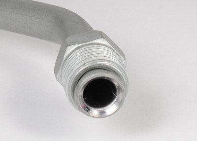

It looks like a single flare fitting from the picture and my old eyes & glasses. I would take it apart and carefully look at the flare on the hose and the machining of the fitting. You should be using a flare wrench to tighten. A few fingers on the wrench should apply the needed force. Not a 24" pipe wrench and two hands.

I will try this then look carefully at the threads on the radiator brass fitting and cooler lines fitting which I happened to find a picture for

I went out and got this pic of lower transmission cooler line.
#1 cooler line male end 5/8" flare nut.
#2 m/f brass fitting 19 mm flare nut.
#3 radiator opening which is I think 1/2" that's why they included this kit
P.S There is a drop of Transmission fluid still hanging in there at the pic.
Thank you guys for interaction.
I think the lines are standard 3/8" double flare id lines. Maybe AAP can just give you new radiator adapters to try. If you have to return the radiator, you might be ahead to get an orginal radiator out of a junk yard.

They're flare fittings, they seal with the flare. Teflon tape will do nothing.
If the flares aren't right, you need new fittings or lines.
Tighten the heck out of that line to adapter fitting, if that's where the leak is. Use two wrenches so you don't disturb the fitting in the radiator.
In the future get yourself a bottle of white loctite for the fittings like the one in the radiator. You can even use it on flare fittings but like said..the flare has to seat in the brass fitting correctly to seal. You may have a deformation in the flare or the seat on the brass fitting. I would pull the flare fitting out, inspect the male & female ends for deformation and try again. One of them is bad. The brass fitting may also be too shallow for the male fitting to seat and you may simply need a deeper brass fitting.
