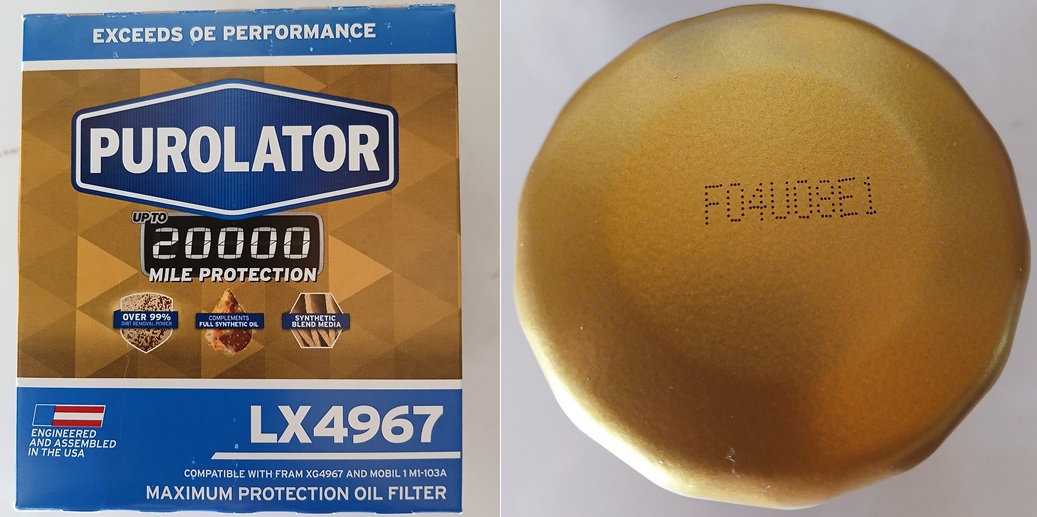

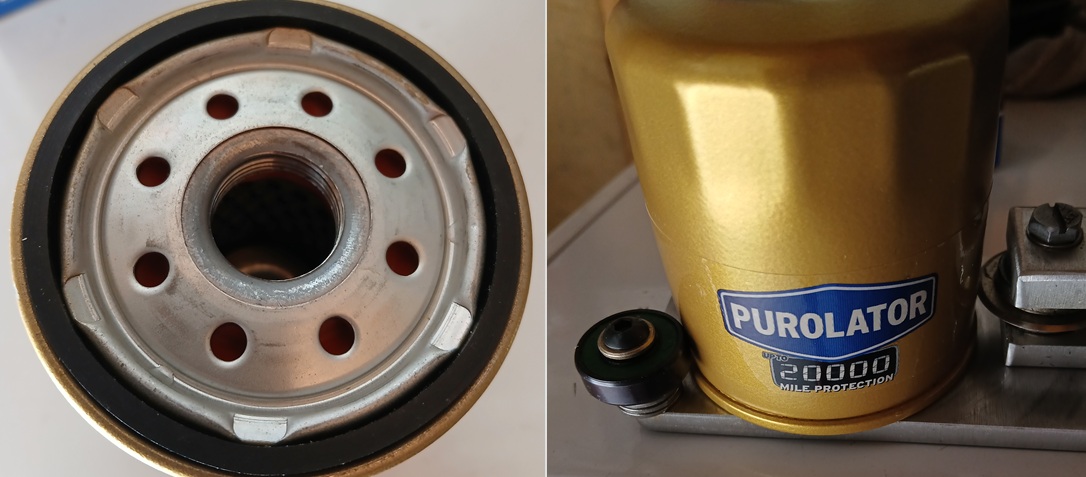

Been using the M1-103A on my Rav4 but wanted to dissect a new Purolator to see if it would be another option I might want to use. Took a quick look inside the four that were on the shelf at Walmart and was pleased that all had wide open louvers so I bought one.

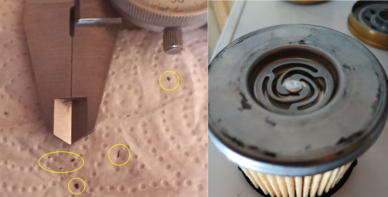

-Several loose specs of glue inside before cutting open. Collected over paper towel. Caliper set at .010" for reference.

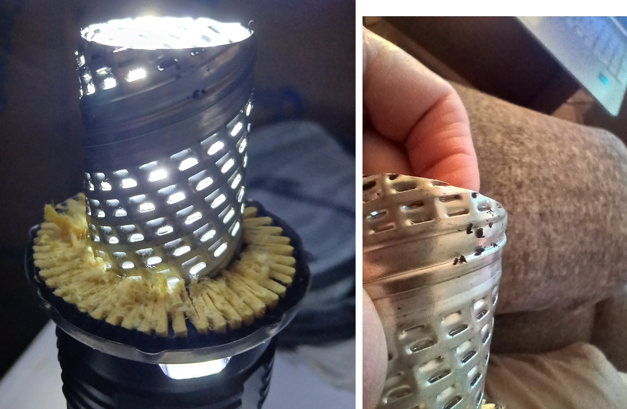

-Discovered more glue in several louvers after cutting away the filter media.

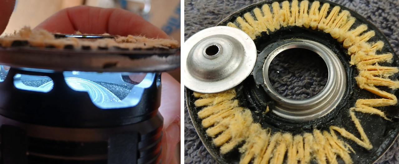

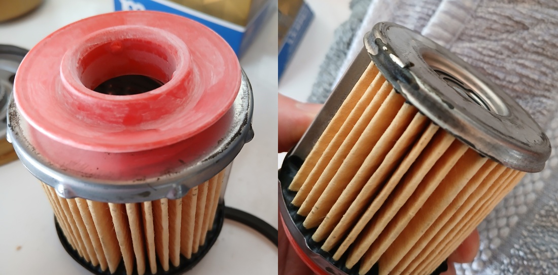

-Excess glue squeezed under the bypass valve.
-Bypass valve not seated with .012"- .015" of gap on opposite side of where the glue made its way under.

Exactly. Just seeing the bits that came out of the outlet side of the filter by shaking it over a paper towel makes one wonder how much more would come out once oil flow/pressure started. Granted some of the ones in the picture of the center tube may have been caused when I cut out the media, but the glue bits that were still in some of the louver openings took no effort to remove.
