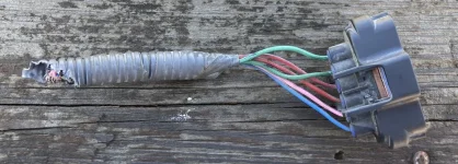

Well, that didn’t take long to figure out once I actually started removing parts. When I reached back to unclamp the air intake I wondered why there was a ragged wire bundle stabbing me in the arm.
Mice had chewed the wiring harness completely in half. It’s not surprising the throttle didn’t respond considering it was completely disconnected from the system! There was dry dog food in the bottom of the air box. I’d been out of town for four days and apparently that was enough time for them to take up residence under the hood.
I figure I have three options: 1) try to splice it back together 2) buy a new wiring harness and try to install it myself or 3) pay a real mechanic to replace the entire wiring harness. If I do 3) I’ll try to turn it in on my insurance under the comprehensive.

View attachment 149783View attachment 149784
Ah, the joys of living in out in the boonies!

I broke the little click tab off removing the connector so Plan A is to get a new one. I see them on Amazon but I’m going to check with a dealer first to see if an OEM replacement is available. A used wiring harness is about $250 on eBay (and much more work) so replacing the whole harness is really low on my list of things to do.

I would try to find that portion of the wiring harness pigtail & plug at a local "Pick & Pull" salvage yard. It is probably common to several Toyota 4 cyl. motors of that vintage. If you are not able to source a new plug, I would just splice it back together with solder and heat shrink tubing and replace the plastic wire loom conduit. You can adequately secure the plug with the broken click tab by using a small Ty-wrap (zip tie) and/or a dab of hot glue. This will be much simpler than replacing the $250 wiring harness.
alot of plugs will stay even without the click tab. i have an ignition coil plug held on with a zip tie. no problems yet

oh good news how clean the throttle plate was! ahh so you'd need a new connector, just like hose ignition coil connectors break too.. I know they have replacements for that, maybe the dealer can get another for the throttle body! glad to hear you're going to be able to get that fixed..(y)

update: had to see what the aftermarket had for throttle body connectors.. replacement.. found SMP (Standard Motor Products) part S2817, at oreilly auto for $12.99 for your throttle body. I found the original part at SMP's website..
What I like about the aftermarket is they include the heat-shrink butt connectors, but hey thought I'd let you know what I found..

There are two green wires on the connector that don’t seem to have any markings to distinguish them. I’m uncertain how to know which green wire goes to which spot on the harness and I’m afraid of frying either the throttle body or the ECU if I get it wrong. Or maybe it doesn’t matter? I hate the thought of paying to have it towed to a dealer and paying someone to splice wires, but the more I think about it what aI would be paying for is their knowledge more than their labor.
This may all be moot because I haven’t actually unwrapped the severed harness. There may be shading on the wires I just can’t see from this limited view. I’m sitting in the hospital with a relative and probably won’t get to work on it for a few days so I thought I would try to gather info preemptively if I could. I debated opening a new thread about this and I still might if I don't get any responses.
