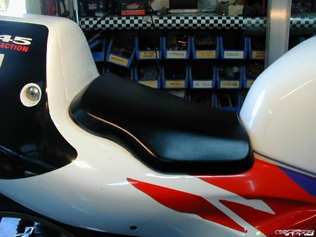

True to it's racing intent my RC45's saddle is firm as a board...

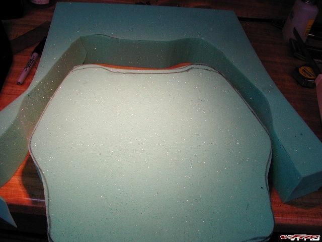

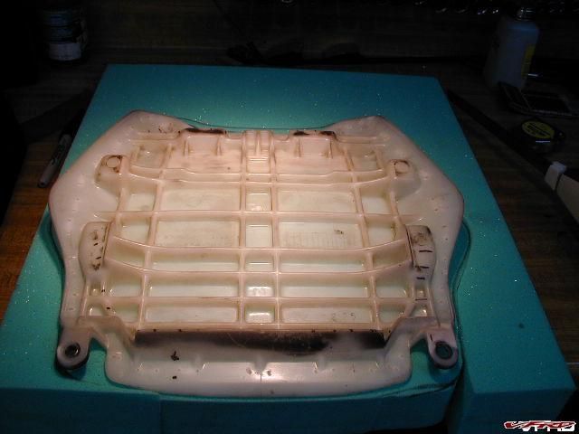

I laid the stock seat pan over a 3 inch block of T47 extra firm Temper foam...
"Temper Foam® is a temperature sensitive foam which gets softer and more malleable when warmed
and firmer when cooled. It is a visco- elastic material ideal for orthopaedic and prosthetic applications.

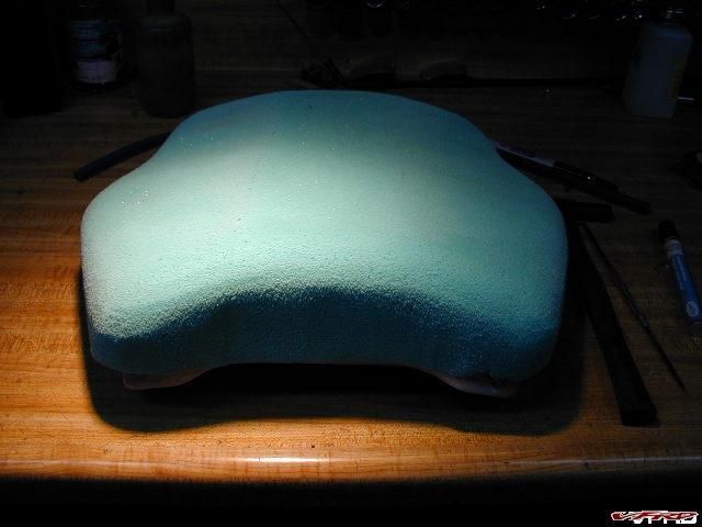

I cut the basis shape using a electric carving knife...
I glued the foam to the plastic pan with 3M Weather Strip or Gorilla
Snot if you will... next I shaped the foam with a air driven sander...
Behold... I went from a 30 minute seat to a 12 hour seat... old guys
know comfort and know how to get it too...
