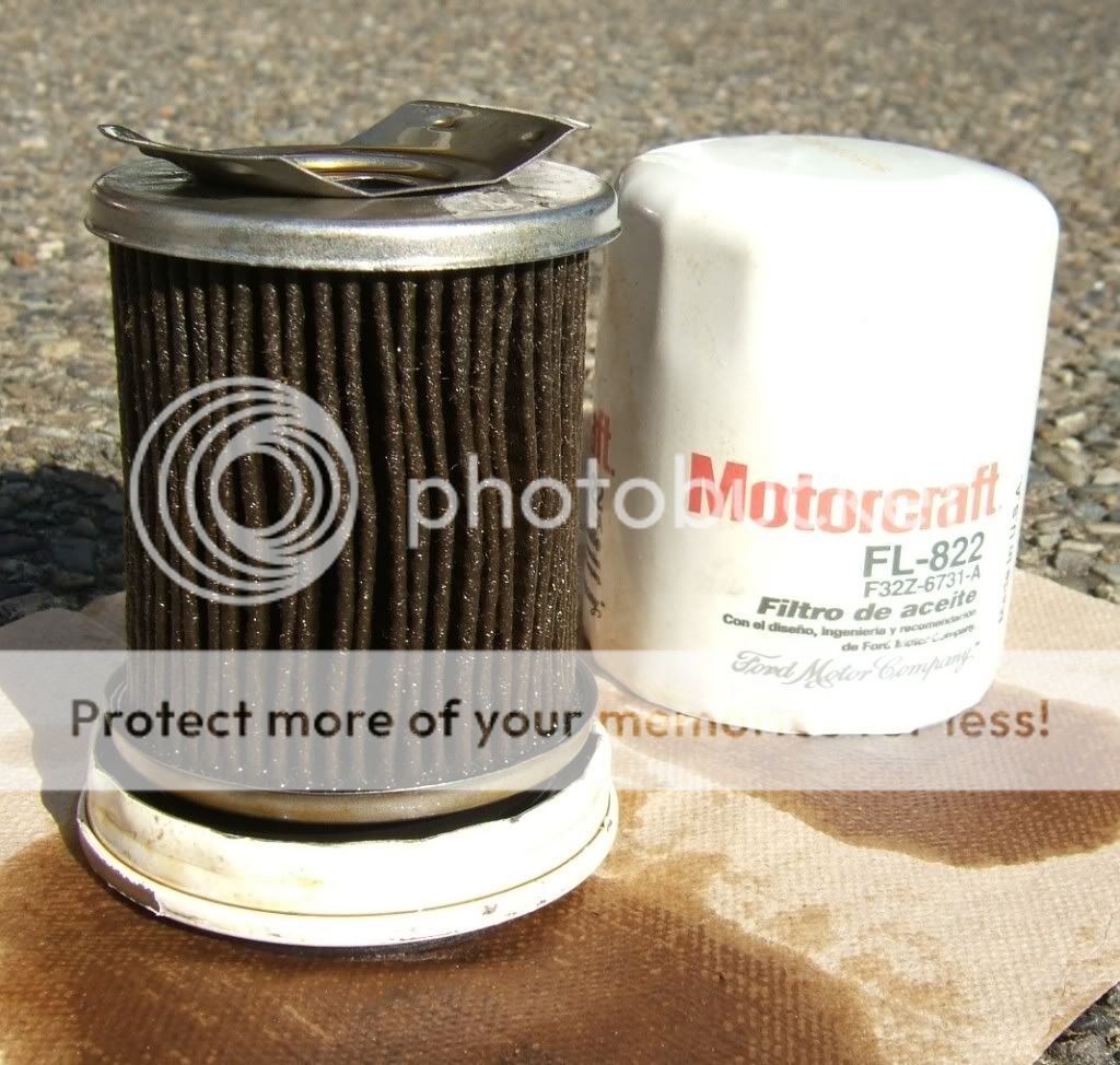

This filter was on my 2004 Nissan Altima with the 3.5L V6 (VQ35) engine. I bought the car used from the local Ford dealership in Jan and did the first oil change since I got it. The dealer changed the oil and filter, and put a Motocraft FL-822 on it when the took the car in, and the FL-822 is the correct MC filter for this engine (first thing I checked after I got the car). The oil was just conventional, bulk 5w30 they had at the dealership.

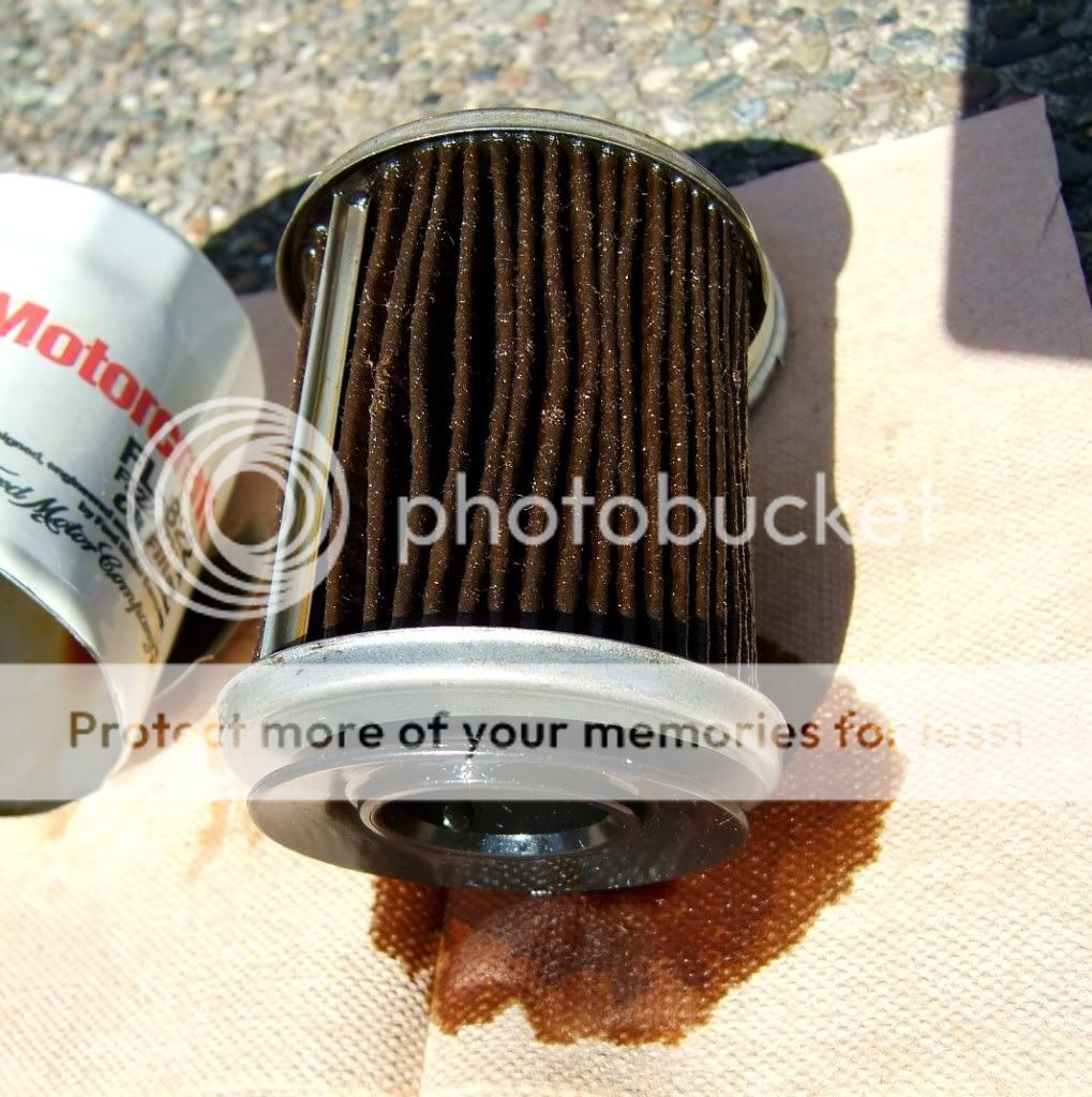

There was 4000 miles on the oil & filter. After cutting it open I was very impressed with the construction and shape of the filer element. I know 4000 miles isn't much use, but it sure looked good. And it was super clean inside ... I could only find just a hint of black debris on the dirty side of the element. The car only has 22K miles on it, and has had regular 4000 mile OCIs.
The bypass valve design was kind of neat ... it had that flat spring with spiral cuts in it. The flat plate riveted in the center to the flat spring is the bypass valve. It took quite a bit of force to make the bypass valve open - didn't measure the force, but it wasn't a weak spring by any means.
The ADBV was still very soft and pliable. I really liked how they integrated the ADBV to make a tight positive seal between the filter base and base end of the element cartridge.
The element has quite a few pleats, so is this a hint that this particular MC filter was made by Purolator? How about that bypass valve ... who makes them like that (Purolator)?
Anyway ... if you have a vehicle that uses this filter I wouldn't hesitate to run it. I put a NAPA Gold (# 1356) on this time (with Mobil 1 Clean 5000 5w30), but this MC FL-822 is also top notch also IMO. I think they are about $6~7 at the Ford dealer.
BTW, these are all the filters that can be ran on my V6 Altima, so this FL-822 should cross over to any of these. These are all the "long version" filters.
