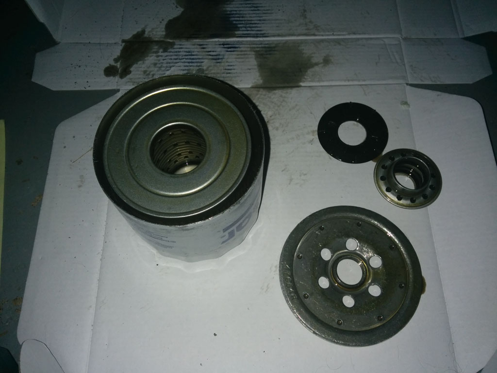

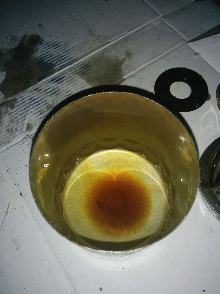

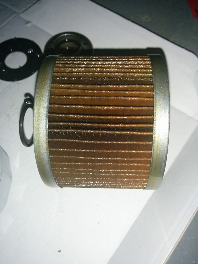

This was the filter I pulled off the Charger with around 500Km on it: The pleat spacing on it was perfect. It looked like that all the way around, I was quite surprised. Seems like an extremely well built filter. The only thing I don't like is the nitrile ADBV which leaked when tested (not much though).

Originally Posted By: asharris7
Looks good. Is that standard media? Blend?
I assume standard paper media. Seemed quite durable, I could not tear it easily FWIW.

Why was it pulled so early? Looks like a WIX clone based on the bypass valve design.
Because the dealer put in bulk whatever oil and I wanted to have a 0w-20 in there for the winter. As per my other thread I grabbed 4x FRAM Ultra's and 4x jugs of AFE 0w-20 so I changed this stuff out early. Think of it as a flush, LOL!

A Wix made Mopar, looks good. For some reason Mopar filters, whether made by Purolator or Wix here use a nitrile adbv. With the exception of the adbv the Puro made Mopars look very similar if not identical to Motorcraft OEM. Thanks for the pics.
