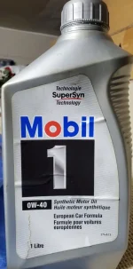

Any difference between these two bottles? Mobil specs the pour point of the new one (left) as -60°C whereas old one (right) states -40°C on the bottle. Wondering if there's a significant reformulation, maybe more GTL base?
Left - new stock. Right - old stock. Possible change in formulation? I believe they're both API SN. Most importantly - still Porsche A40 rated.

I don't understand the inconsistencies in the information Exxon-Mobil provides. From the same page the PDS states -60°C and the MSDS states -42°C.
The -42°C is from the Feb 2022 MSDS.
ASTM D97 test procedure for both.
think its error, dont know really why they messed that up... but the formula have more pao in it nowdays
Do not trust the msds pour points for mobil oils. Some of the mobil 1 lines have the pour point listed as 90 degrees celcius others 0 degrees celcius. Obviously those numbers are false. Trust their pds
