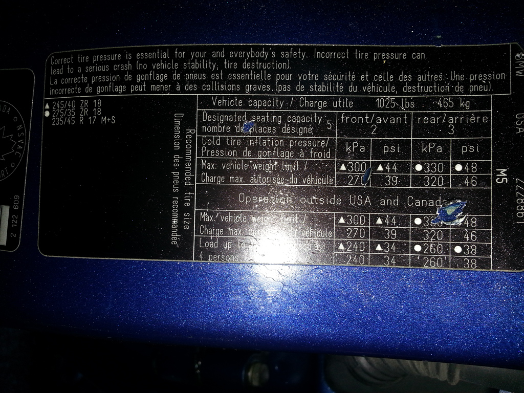

Just thought I would add the following related question.
The door placard indicates 33/41 PSI for max load. However, no recommendations for light load. Most of the time I drive by myself. Anyone have suggestions for how to compensate with a lower tire pressure? I am thinking about 30/36 psi???
Originally Posted By: 190E26FTW
I guess it depends on the car maker. Mercedes has PSI ratings in gas door and it says for 100mph driving add +7PSI to Max tire pressure load.
BMW has a similar system, but they use # of occupants:
