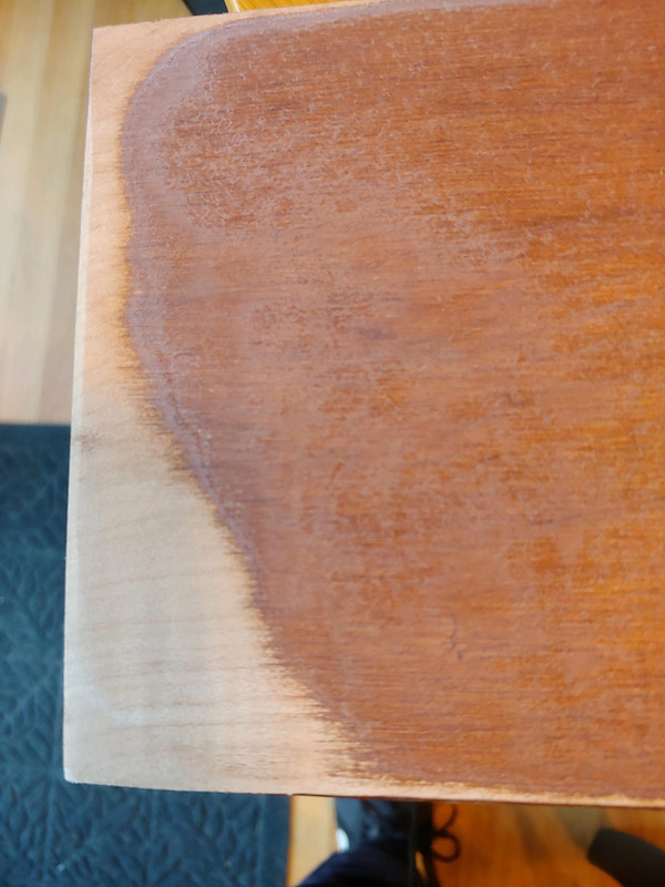

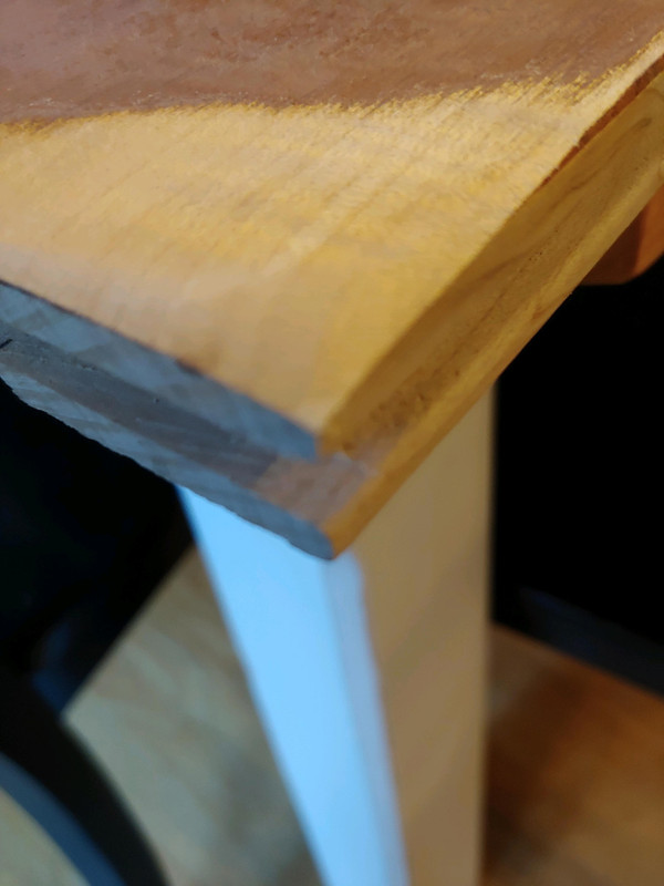

The estimator guy maybe led us astray. I found some in the shop................the existing floor downstairs is REAL wood, maple I believe. Help me out here, anyone know about this product? I think discontinued
I sanded a sample:
Looks like real hardwood. Can it be refinished?
Do the make an in situ finish with aluminum oxide?

I'll take hardwood flooring over fluffy bacteria traps any day. I'd certainly have the steps refinished if possible.
Based on what I see in those pics, that's real wood and can be refinished.
I don't know what the cost would be for what you want though.
Yes and also not trusting first floor company.
I called Mohawk Tech support. No longer made, but yes real maple. Thanks!
