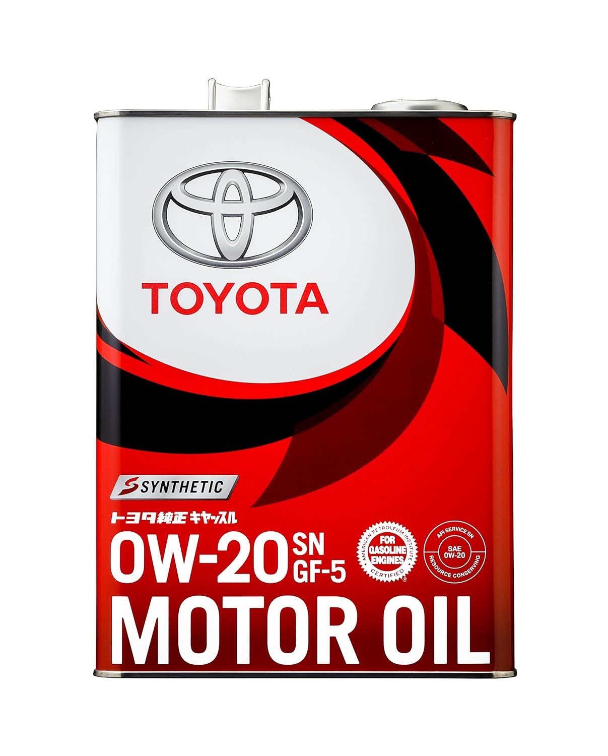

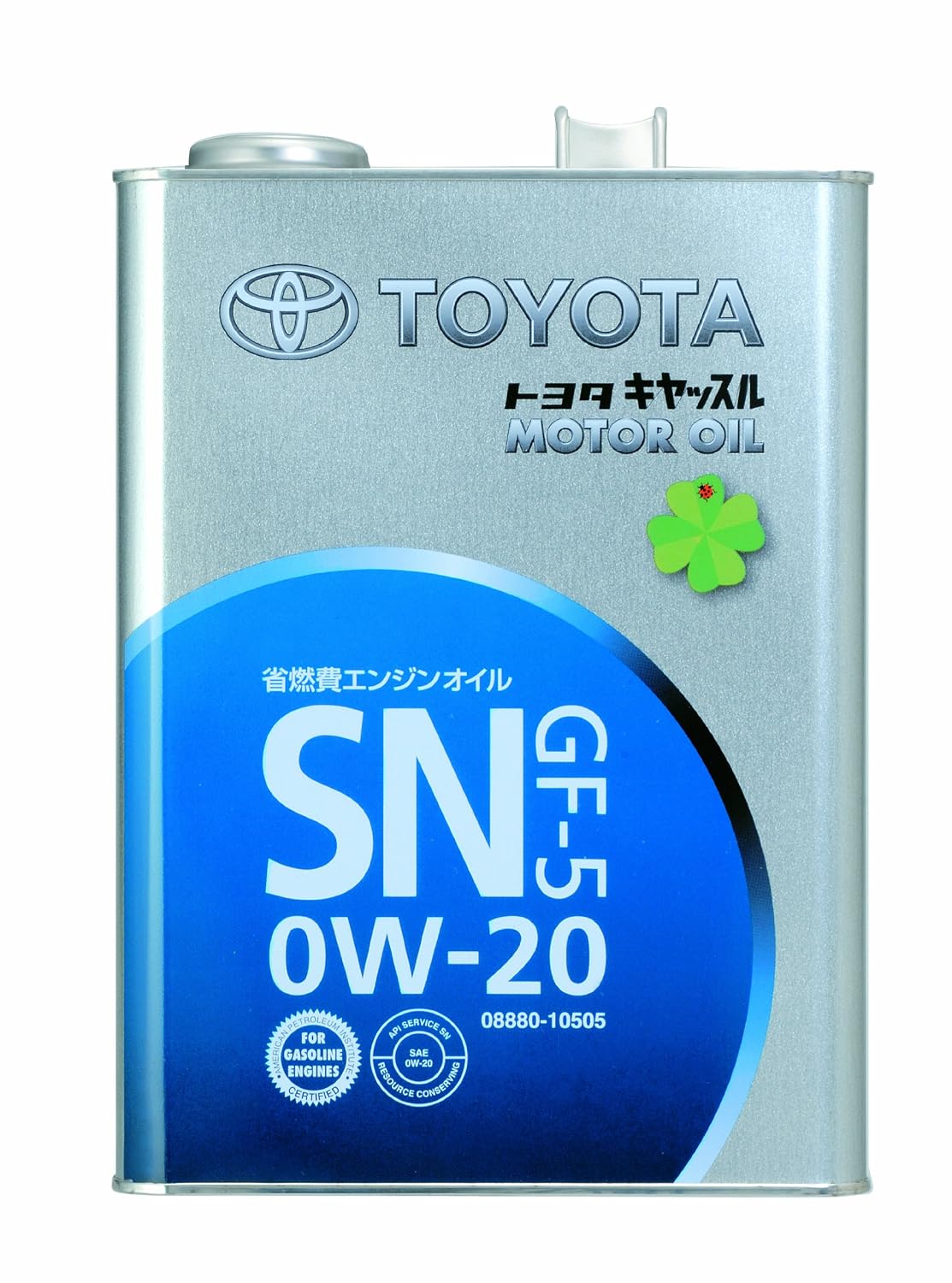

e.g. the pre-2017 blue Toyota Genuine Motor Oil 0W-20 is stated as mineral oil.
It was until 2017 when they released the new red 0W-20 which is based on synthetic base oil for better fuel economy.

Guess I would take a look with the new Toyota Motor Oil.
