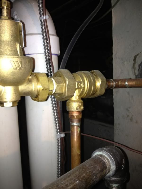

Got our ultra high efficiency boiler installed last Jan. was down in the basement tonight and saw moisture under the boiler.
It was this:
Which I believe is a backflow preventer.

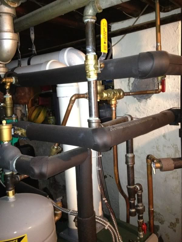

It is part of this network:
Which has a valve where it attaches to the cold water supply , then that gadget, then the auto filler, then another valve and then it connects in a t to where the pressure tank is.
So it is dripping. It's a consistent drop, not a flow, but a drip.
Is this all as long as these things last? I didn't notice a country of origin, but some of the iron pipe that was used is marked China.
My boiler runs year round as it heats our indirect water heater. I have no reason to think/fear a leak, but I assume that is why the auto fill is there. Any reason why I should be concerned about closing off the two valves to prevent the dripping? Right now I have the pipe routed into the condensate pump so it isn't dripping onto the floor.
Thanks!
They aren't hard to pull apart. might just have a bit of junk it in.
Or bleed off some water from the boiler and so fresh water flows through it, might clear the junk.
It doesn't take much to get those BFP's to leak...a little crud on the seat is all it takes. Often a quick tear-down and cleaning is all that's needed. Yours looks like it has a union-type connection on each end, so you should be able to close the ball valve on each side and take it apart.
