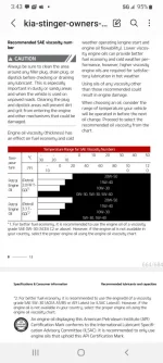

It is not calling for ILSAC. It specifically says A3.
SM or ACEA A3. To me that reads minimum HTHS 3.5. SM can be some dino 5W30.
But I get it is confusing. It is KIA after all. They managed to be even more sloppy than VW.
Yes, it’s very vague. I believe it was Hyundai that “required” a spec that was non existent. (Can’t remember the specifics.)
To add to the mess here is a page out of the 2021 Kia Stinger owners manual (European edition) I'm gonna try some Amsoil SS 5w50 It carries a API SP rating and HTHS 4.45 Hopefully this oil makes my tuned Stinger GT 3.3tt engine happy.
