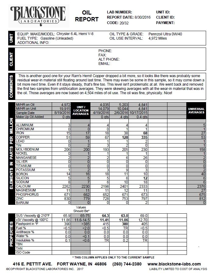

I have 4 oil changes on this oil with my RAM 6.4 using a 5K mile OCI. In two out of the four changes, it sheared down to a heavy 30 weight and marginally stayed in grade for the two other. Had I gone to a factory 8K mile OCI, I do not think the other two would have stayed in grade.
That being said, I still think it is a good oil, just not shear stable for the grade called out.

Does your RAM 6.4 call for 0W-40? Does the manual state the engine could endure damage, if it shears to a high 30-weight?
The RAM 6.4 Hemi owners manual calls out a 0W-40 meeting the FCA spec of MS-12633. That spec has limited applicability and is basically regulated to the RAM 6.4 Hemi and the SRT 6.4.
PUP 0W-40 and Mopar 0W-40 (relabeled PUP) have licensing meeting the MS-12633 spec with maybe AMSOIL 0W-40 saying they meet it but are not licensed for it. That being said, I am using the proper oil called out in the manual.
I am not worried about it as RAM engineers have made comment at launch of the RAM 6.4 engine that all durability testing was done with conventional 5w-30 oil. So I am not worried if it shears to a 30 weight.

You have more copper than the Penny Mint in Washington D.C.
Copper oil cooler fins perhaps.
I am not worried about it because it is trending down. Most late model 5.7 and 6.4 Hemi's run high copper numbers compared to most and usually level off in the 30-40 PPM range. It is from the oil cooler lines and cooler radiator.
