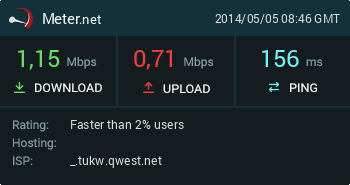

Image of Test 3 results:
http://www.meter.net/rs/20141729785.png

Results are a bit slower on average with the download speeds only then when tested in PL with Opera. Upload speeds look about the same.
There was good correlation between www.meter.net and speedtest.net on these tests.
