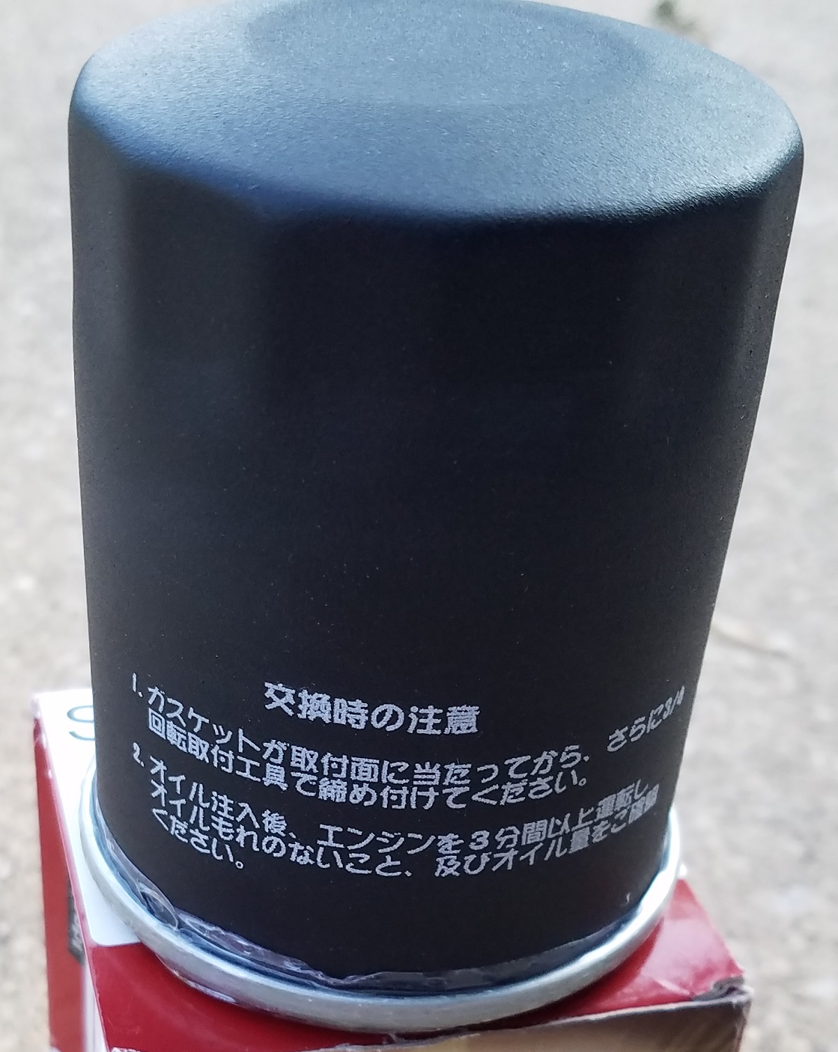

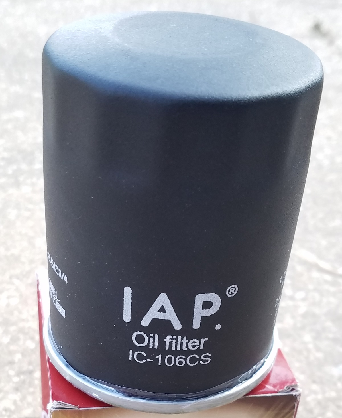

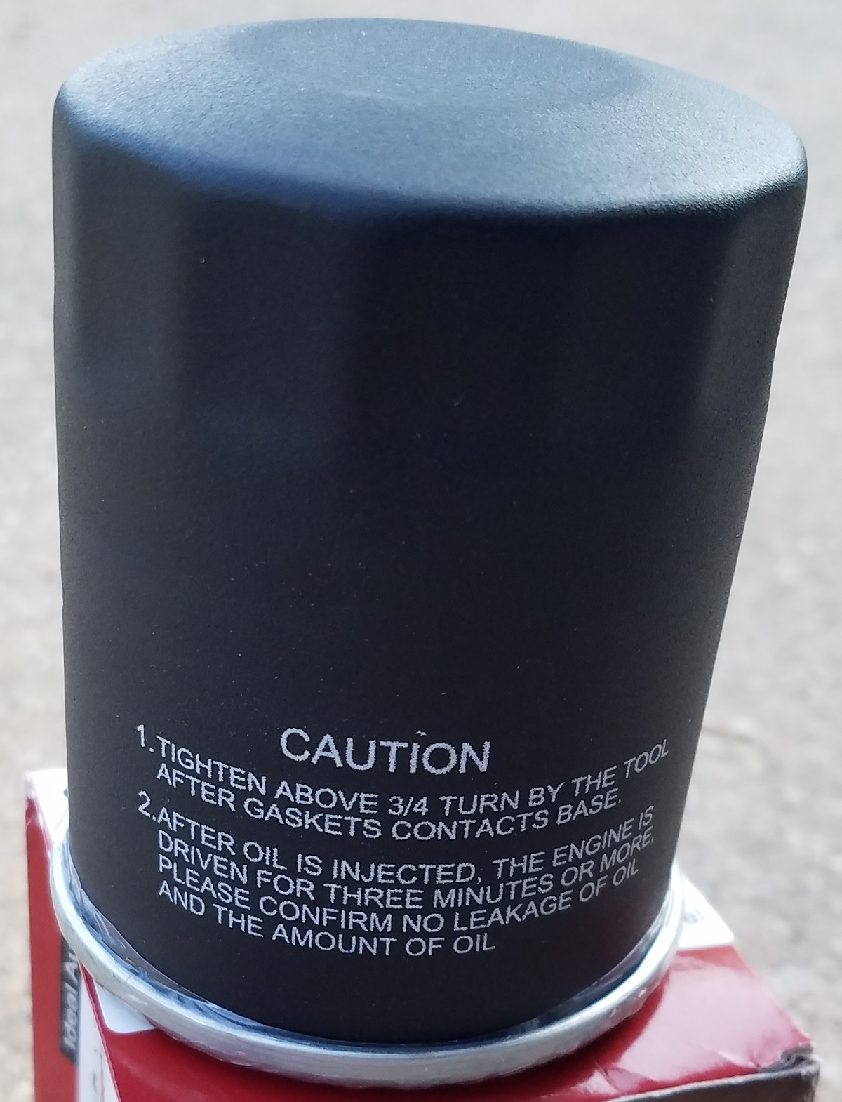

A few weeks back, I was stumbling around Ebay looking at filters for my Frontier and came across this IAP IC-106CS filter that was advertised for $1.88 shipped and peaked my interest because shipping would have to be more than the cost of the filter and wanted to see what one could get.
http://www.ebay.com/itm/IAP-Oil-Filter-IC-106CS-for-Honda/112302138156

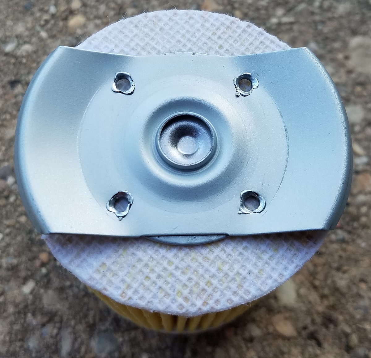

Arrived out within the week by USPS First Class out of California and below is pictures of the filter before and after being cut open. Observations show it to have a prelubed gasket under the cellophane covering. The bypass valve is of a weird design I have never seen before and is some kind of metallic poppet plate design. Media was tight with about 60 pleats and measure apporx. 250 sq in of media. Center tube was much like a E-Core but with a two piece plastic ring design. Media had a fiber end cap but was resin impregnated and could not be peeled off by hand. ADBV is nitrle and was very supple but also on the thin side.

Construction looks decent. Not sure about the bypass valve. Hard to tell how it works by looking at the photos.

Interesting design. An ecore element as you note, but the pleating looks tight and uniform which is a plus for an ecore. Different type/looking bypass. I'm not going to question how it works. The Champ Labs clicker type bypass looks odd too imo. I like the looks of thread end element adbv sealing area as compared to the Champ design.

I drilled out and took apart the bypass valve and it looks like a dimpled plate that fulcrums on a strip of spring steel.
Looks like the black rectangle piece of metal in the bypass valve works as a "beam spring".

Looks like an "adaptation" of Champ Labs Ecore technology coupled with an "adaptation" of Champ Labs "clicker" BPV technology. I don't recall ever seeing an Ecore with clicker bypass produced by Champ Labs. Champ Labs Ecores in applications requiring BPVs have either had combo valves or coil spring design BPVs.
The Champ Labs made AC Delco Classic PF1250 (non-Ecore) is an application that was still using clicker BPV last I looked at one of those.
