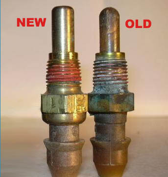

Well I decided to use the hot thermostate at 192°f. It runs dead in the middle of the guage mostly and just a tad higher when the fan kicks on. Also did a Italian tune up and seems to run much better now. Definently has better heat aswell. I didnt change the temp fan switch cause the old one is still working. The car has 211k on it and had original thermostate or at least one that said Made in Germany as the OEM ones say.
