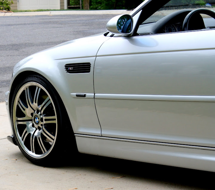

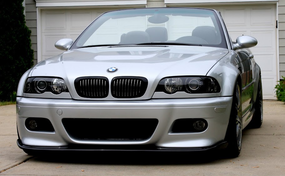

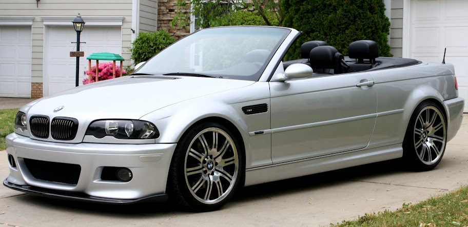

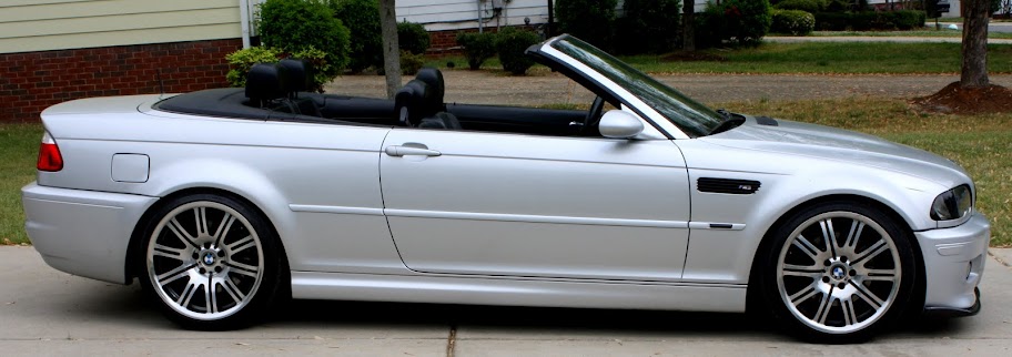

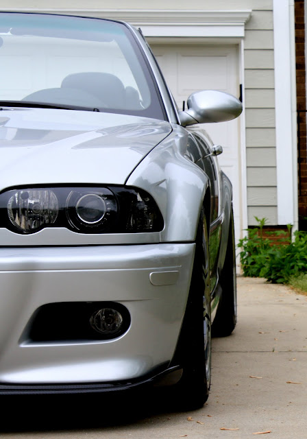

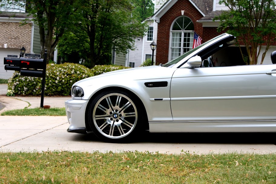

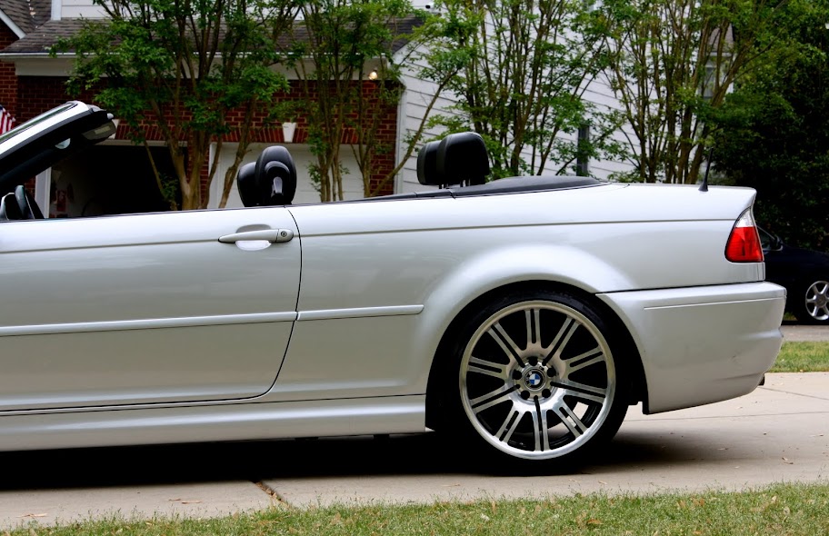

Hey, thanks, Homer! :) No doubt about it that I love the car...just ask my wife. She's pretty jealous of it. LOL
Thank you for all of the insight and pointers. I feel pretty good about it after considering your well thought out responses.
I appreciate it!

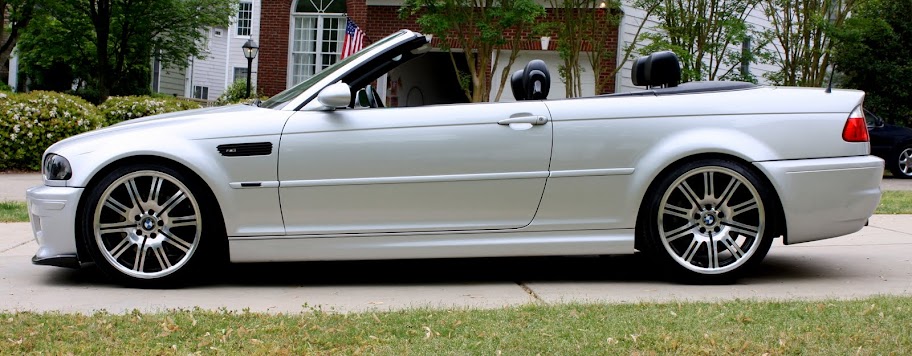

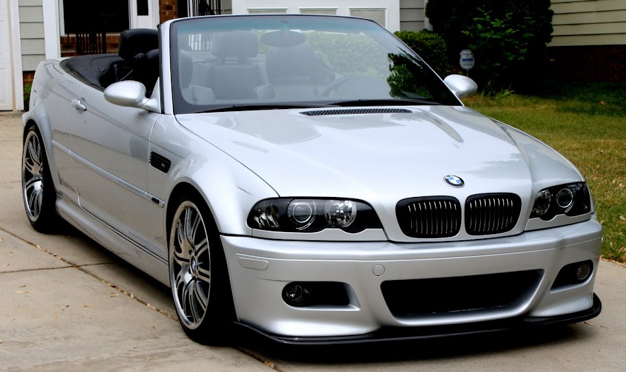

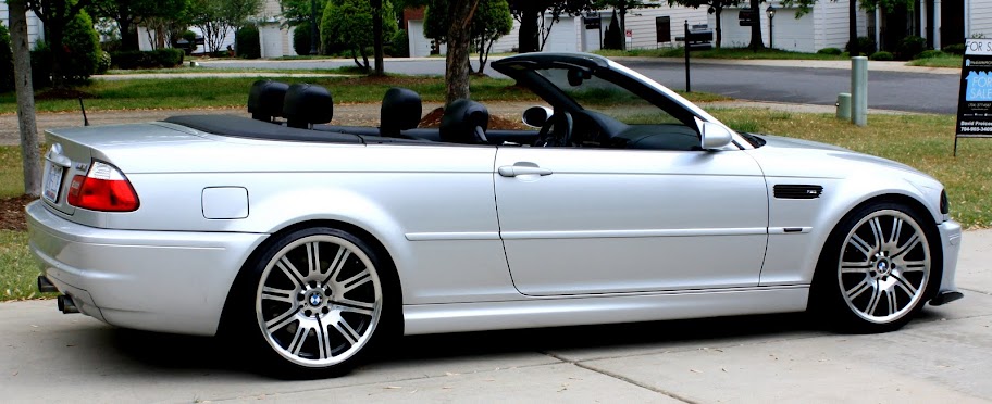

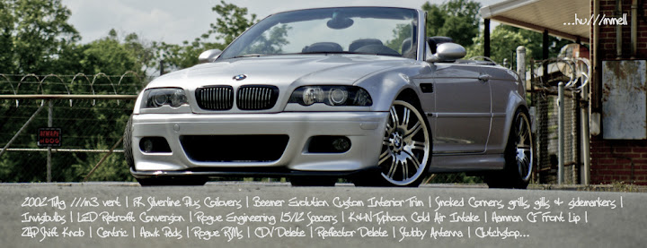

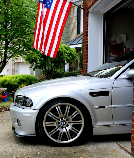

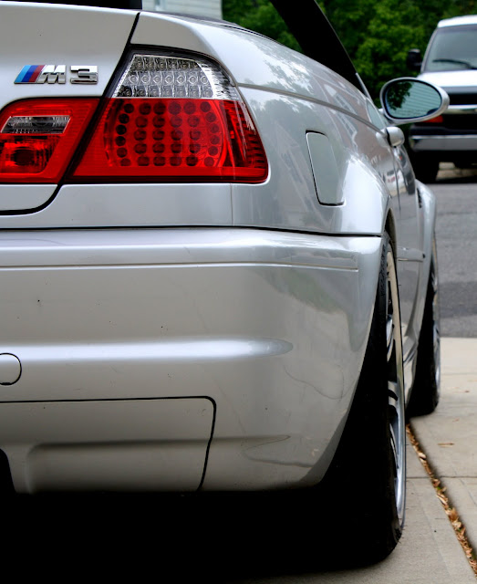

Here she is:
.. Not a Problem, Hummel! I too have fond memories of my Ultimate Driving Machine. had to sell it. So, to reach back and help out another BMW loyalist, and that is a -FINE- E46 (WASH THE BUGS OFF THE BACK!!! lol,) .... Keep On Truckin. :)
