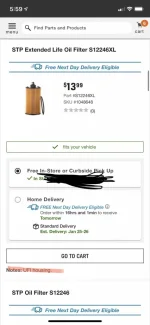

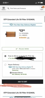

So what you’re saying is that Autozone is more in the know then dealerships? 😂. Autozone website has the different filters listed and under notes near the product # it says Cartridge Housing, Hengst or Cartridge Housing, UFI.
I realize that people servicing the vehicles may not care as much as the DIY person maintaining their $25k vehicle, but this doesn’t make sense to me. Basically, the responsibility lies in the hands of the lube tech servicing the vehicle, who isn’t educated at all to the TSB, nor the parts department who looks it up in the parts catalog and the oil filters are only listed for Hengst. How do you run a business operating like this - unless no care is given and it’s only money in your pocket for ruined engines.
There seems to be a failure in intelligent decision making regarding the different housings and opportunity for mistakes, a washing of hands once a TSB is issued from GM and a lack of communication and training in the service departments.
