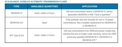

Going to do a drain and fill on a AF50-8 in an '18 Regal Tour-X. The manual says to use AC Delco AW-1 fluid, however recent GM docs online say to use regular Dexron VI (see attached image). What is the best fluid for this application, is the AW-1 anything special, or can I use a run of the mill universal such as Maxlife / Dex VI?

AW-1 was never specified for the in-house GM 8 speed transmissions, only the Aisin units to my knowledge. However the chart I pictured shows that Dex VI supersedes the AW-1 spec. I gather from GM's documentation that Dex VI fluid is interchangeable with AW-1, which is music to my ears.
