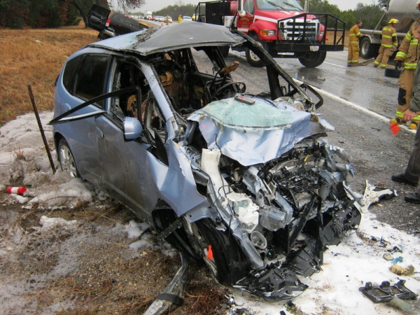

This is the vehicle yes?
First, the roof structure has nothing to do with the front aprons and front bumper, both of which are completely collapsed and crushed. If this is what a Honda Fit looks like in front of the cowl after a 35mph impact into a stopped vehicle on a wet road which would provide less collision force as it slid away than I gotta tell you, there should be a lot more dead Honda Fit owners.
40MPH into a stationary object.
Watch the roof skin. Watch it flex and warp as impact energy is transferred around it through the pillars. This is why the roof panel came off when it was glued, not because it was directly exposed to impact forces, the STRUCTURE it was attached to transferred the energy away from the impact and the shear strength of glue is less than welds so it came loose. You're assertion is that that thin flat metal panel is what is is keeping the passenger cage mostly intact. That the A pillar (windshield pillar) made of boxed super high strength steel that buckled was bolstered by that thin piece of metal?
Also isn't it funny how that Fit looks a lot like the one in your example? The one that had a "low speed minor impact" looks a lot like one in a normal speed offset head on impact? Again, either your facts are off or there was a lot more shody repairs done to that vehicle than a roof skin replacement.
