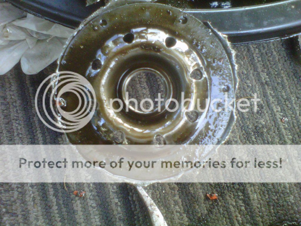

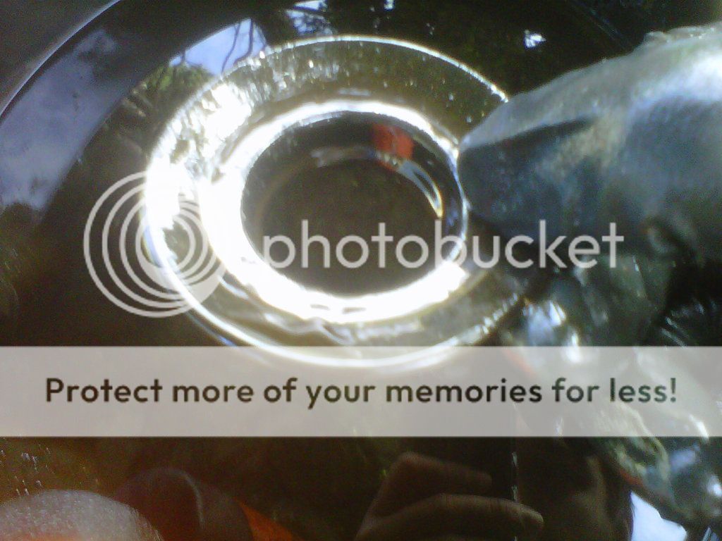

This filter came off my old work truck. A 98 GMC 2500 with a 5.7L V8. It had barely 3000 miles on it. The oil was Mobil super 1000. I was driving up a steep hill when suddenly the engine lost power rapidly and the temperature gauge shot up while the oil pressure dropped to zero. I had no safe place to stop for a few hundred feet. It stalled just as I got a spot to stop. My bet would be on oil pump failure and then the engine just shredded itself. Look at all the metal shavings that came out of the filter. The filter held up better than the engine. Date code: C10743
Here are the drain pan photos. No I wasn't panning for gold.

If the oil pump broke, dropped a shaft or something, that oil and debris would not be in the filter. Need to look further when you tear it apart. I suspect something else entirely like a jumped timing chain, spun bearing, or a lost cam ...

More likely the engine spun a bearing. Unfortunately common on the Vortec 4.3/5.0/5.7 if they've ever suffered coolant ingestion in their life due to faulty intake gaskets. I've probably rebuilt a couple dozen that suffered similar fates. Although I'm happy to report every one I know of that I rebuilt is still running. The highest mileage one is in my friend's truck with 205,000 ish miles on the rebuild. Bummer, sorry about your luck. If it's any consolation it was already junk when it lost power.
