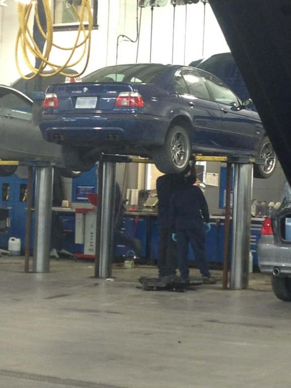

M5 pics please??
I've only got this one from the job:
This was taken by another mechanic at the shop, he's friends with a girl I know who gets her car serviced there. When I told her my car was up there, she told him, and he snapped this pic and sent it back to her. She sent it to me.
They washed the car when they were done and it looked beautiful. However, a couple of birds have dropped some lovely droppings on it as of this AM
