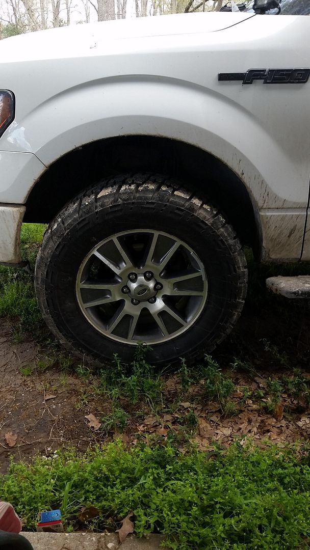

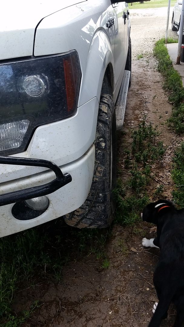

Finally mounted my 35 12.5 20 general grabbers on my stock rims and all I have is a 2.5 in level in the front they ride great pretty quiet for a mud tire too they rub on the uca at full lock but no big deal other than that there is no trimming needed
Stock is around 30 inch if I remember and I never buy tires for mileage I need the aggressive tread I'm usually off road every day when I work so it helps a lot and crazy enough factory rims are the only way it's possible without a lift
That weight looks huge and doesn't fit the wheel profile very well.
Tires look great.
The massive weight on your front left wheel. That thing is huge, and they should have put the weight on the inside of the wheel, not the outside as if you have steel wheels. I'd throw a fit.
Oh lol yea typical ford dealership for ya I'll probably "sling one off" then go in and have them do it again it's the typical song and dance with them they love getting to do the same task over and over at my dealer instead of doing it right the first time I didn't complain cuz I was already running late for a concert in Houston
I'd get sticky weights like for flangeless aluminum wheels stuck on the middle inside.
Something that size and aspect ratio usually does ok with just a static balance.
