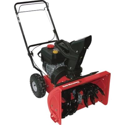

Yard Master Cleveland Ohio Elec start 4 Cycle 179cc i think he said he used it twice....next door guy takes care of him so he wants to sell it. model number on sticker 31amzn1b700 maybe the 1 is a I as in Let it snow paid 600 i think..sell for 300..seems fair. any opinions?

Do you mean Yard Machines? I dunno that I've ever heard of Yard Master. I'm assuming based on some of that model # (can't find that exact #), it's one of these: If it's pretty much brand new, $300 is a good deal given they are $600+ new. These are a very basic, single speed self propelled unit. I believe one hand-bail runs the auger/impeller, the other spins the wheels. Joel

With that model and any slush and he will still be shoveling... Better off buying a 200$ single stage used toro You dont really want the cheap bottom of barrel 2 stage (its a 2 stage) You want a decent 2stage or decent single stage. With a cheap 2 stage you lose all the advantages of 2 stage and they dont work worth a [censored] on slush. I've had both.. my 5hp toro throws slush about 15-20ft easily clearing the driveway. They are also not very durable and are known to fall apart or die within 1-3 years commonly.
179cc without a brand name is code for Chinese engine with a carb that will need replacing after a couple years, a gas line that will leak after the second season, and bolts that will begin rattling loose almost immediately. Along with the chinese engine comes a scraper bar that will last for 10 snows, a frame that will rust through in a couple years, cables that will rust and break soon, paddles that will melt away almost as fast as the snow, and other delightful little problems you won't get with a used Ariens, Honda, Toro or even a 10-year-old Murray with a Tecumseh 2 stroke or snow king engine. Enjoy!

Hm. I have the 26" Craftsman which is almost the same thing as this, with the 208cc engine. Did I replace the carb? Yes. Have I really had to replace anything else? No. So many people recommending single stages. No thanks. 3 years old, ours has no rust, cables are all fine, belts are still fine, the paddles on the impeller are fine, still on the original shear pins. They aren't the highest quality machines at all, but they aren't the worst either For $300, go for it, that's a good deal. When you finally do have to replace the carb, just pick up a genuine Honda carb, which is pretty much a direct fit. Also, these 179cc engines are 5HP engines.
