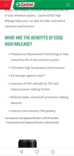

I've always been curious about Edge High Mileage. Have you installed it yet? High mileage oils used to be said to have more antiwear additives than their non-high mileage siblings. I wonder if this is still the case?

Not yet. This is what the claim for high milage is. Apparently high phosphorus Replacement Technology for emissions systems.

HM oils seem to work just fine for me, but seem utterly unnecessary. In some cases, the HM oil's main point is higher viscosity. All the additives in the world don't replace sufficient viscosity when it's needed. As could be the case with a slightly worn engine. With your OCI's, I'd suspect your engine has exceptionally low wear.
In your case, the standard 5W-30 M1 should be just fine throughout the engine's entire lifespan. If you feel you need more viscosity, step up to regular M1, 10W-30. Or even a 5W-40 M1, like Delvac 1.
