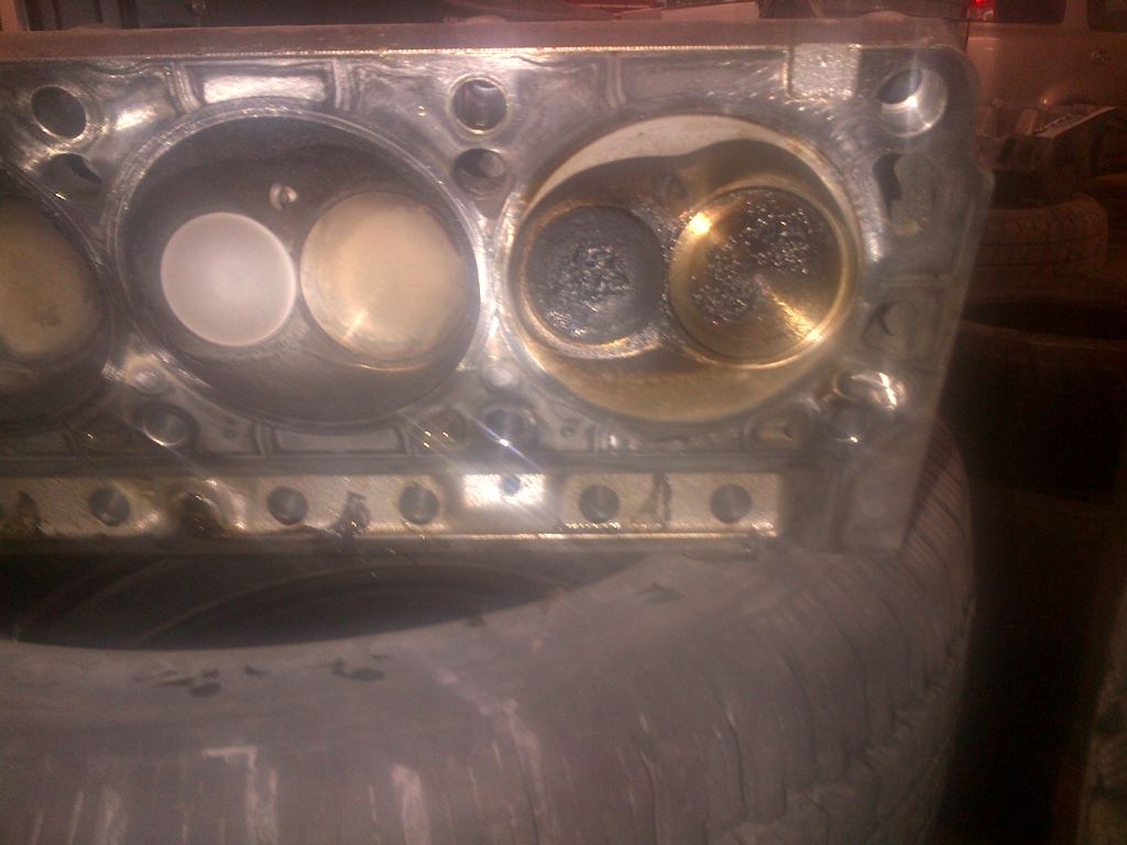

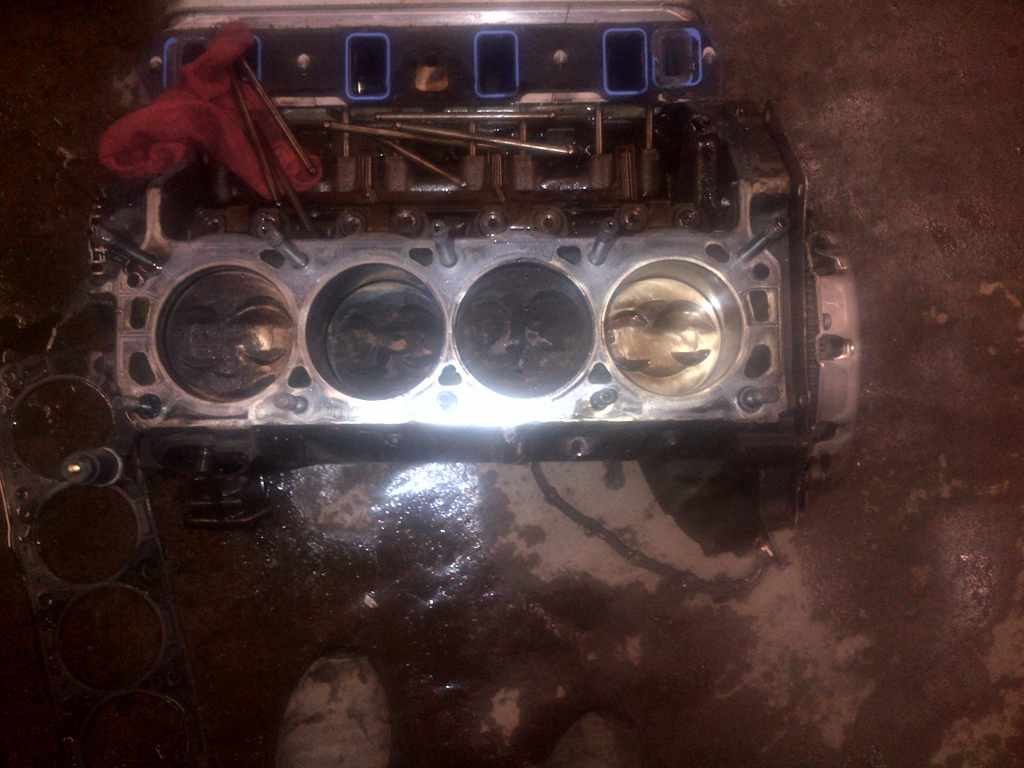

Water believe it or not is an excellent solvent. I've seen people soak pistons overnight in seafoam during rebuilds and there was no difference in the amount of carbon on the pistons.
A gallon of distilled water is considerably cheaper than a few ounces of seafoam or any other top end cleaner that may or may not produce similar results. I've seen cars that have had the heads removed to replace a leaking HG, the piston that had the leak was comparatively spotless against the other cylinders that weren't effected by the leak.
Also there is no real rigging up to do. I already did that when I put in my vacuum gauge. All I would need to do would be to pull the vacuum hose off the gauge and put on a constricting device to suck water slowly.
Guess which cylinder had the coolant leak? LOL
Originally Posted By: leeharvey418
Is that crud on the valves or are they burnt?
Crud. That cylinder was burning a fair bit of oil because of the coolant wash-down which fubar'd the bore in that cylinder. Due to it fouling plugs, the exhaust valve didn't get hot enough to stay clean.
Originally Posted By: Vikas
I am confused; those two pictures are from the same engine or different engine??
Same engine. One is one of the heads, the other is the block.
Well how about that...
