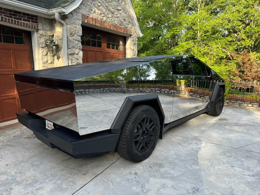

Cybertrucks rust in the rain.

This is from the lead tesla reliability engineer. Wes
The explanation is that there were little bits of iron from manufacturing that embedded in the skin.
He said he immediately recognized the dots from cars he’d seen in an auto shop: tiny flecks of iron or other metal had likely landed on the Cybertruck in Tesla’s factory or during delivery. That metal, he said, is more likely to get embedded in stainless steel than in a car with a paint job.​
“Sometimes if it lands on a car and gets kind of trapped there, [and] if it's exposed to moisture or rain, it then rusts. But it is that iron that's rusting,” Demaree said. “That's not something you can just wipe off, it really grabs on to the surface.”​
And finally......it will buff right out. :D
