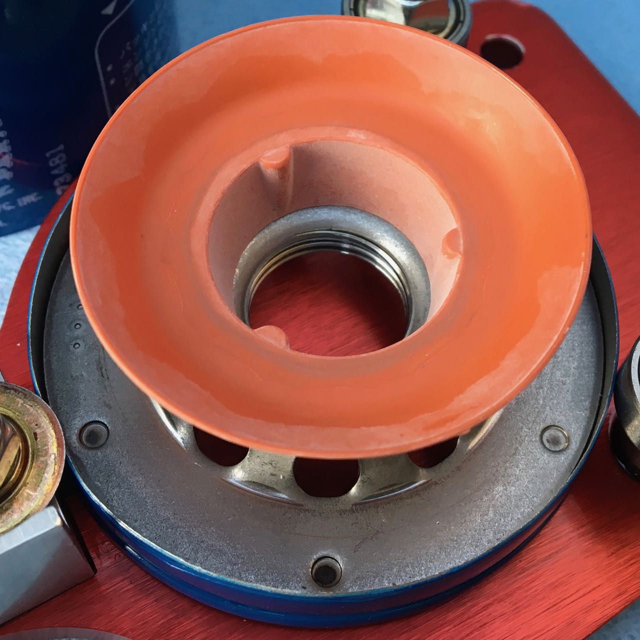

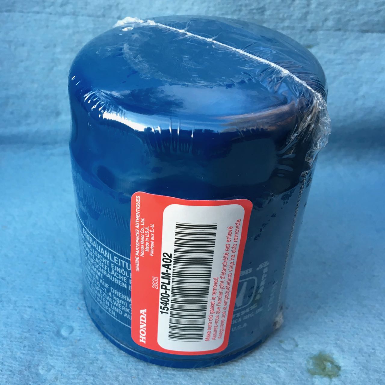

[Cut Open] Honda 15400-PLM-A02 (Fram) - Virgin
Oct 20, 2005
10,322
Scruffy City
Thanks for the C&P.
I have 25+ of these A02 laying around and will use them. What do you think about it? Also, anyway one can find date/year code from them?
You are welcome.

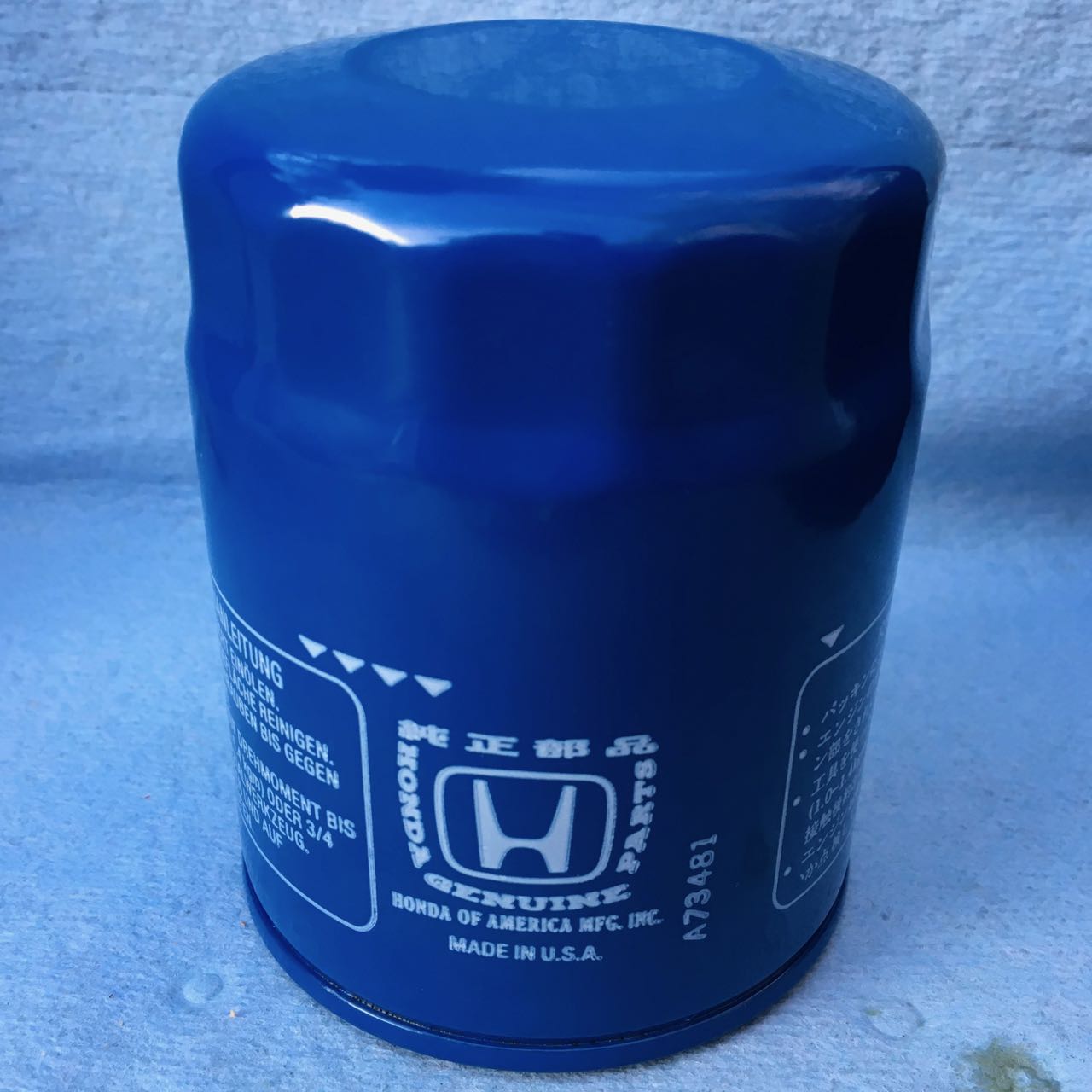

I think they are fine filters and would have no issue using them if I had 25+ of them. I particularly like the “p” gasket, the blue paint and the lack of that abomination of sure grip.
The A73481 is the date code. 2017, 348th day. (December 14, 2017)
What's wrong with the sure grip???
Does this cross with the Fram 7317??

I don't see honeywell anywhere, but I can look closely. It should not be from 2006, hopefully! Lol
It is pretty obvious, also IIRC the older ones have an Honda H on top of the can. Guess they were working on Sat in 2016, maybe they always do?

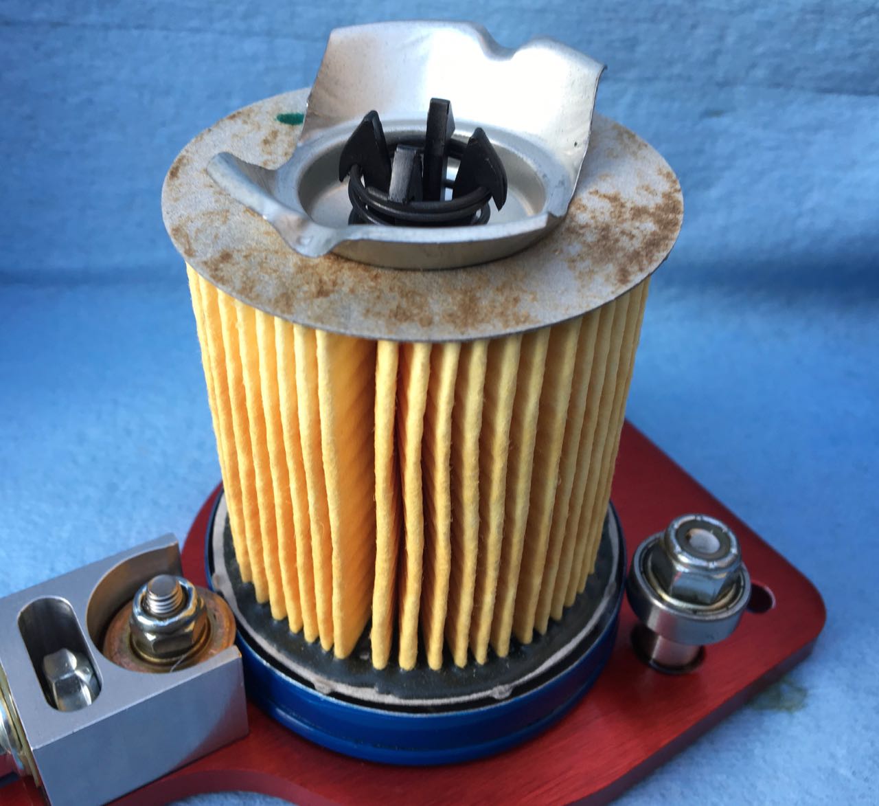

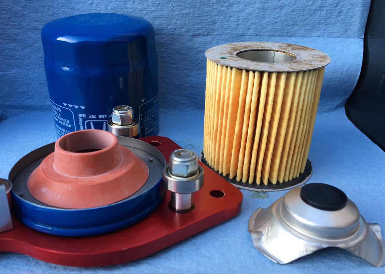

Apparently neither according to Jay at Fram. The A02 filter is in the 50-60% efficient at 20um range compared to the PH7317 that is 95% @ 20um and TG7317 that is 99% @ 20um.
So this filter, what looks to be a fram e.g./tg clone, is recommended to be changed every other oil change by Honda? Meaning it would likely see more than 12k miles if going by the MM? Why is everyone afraid to use the e.g./tg more than 10k with the same cardboard end cap designs?
The Honda filter is less efficient than the EG or TG, probably so to be able to be ran 2 OCIs without loading up so fast.

Some people cringe about the non-metal end caps, and some don't. From an engineering point of view they work and they don't fail, and the bond between the pleats and end cap is very sealed and strong. So if it works well does that sill mean they have to be metal to be good? Lots of filters these days don't use metal end caps ... some don't even have end caps, but instead glue every single pleat end together to seal them.
Originally Posted By: ZeeOSix
... Lots of filters these days don't use metal end caps ... some don't even have end caps, but instead glue every single pleat end together to seal them.
True, and those are very unlikely to rip at the end of a pleat the way filters with end steel or plastic caps can, because there's less stress on the media. Good design!
