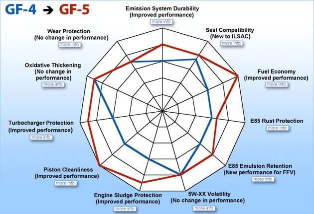

Depends on how you drive the car, the type of car etc.. In most engines, probably not. It is clear though that the industry is demanding oils that handle piston cleanliness better. Just take a look at Lubrizol's GF-5 chart. Synthetics are the future, people need to get over it.
http://2.bp.blogspot.com/_xcPUl6xu56w/S9aKFHr5L5I/AAAAAAAAAF8/faTN-kS-3Fs/s1600/GF5+chart.bmp
