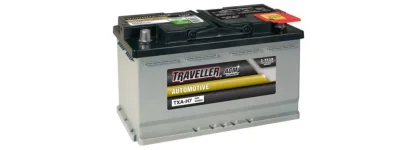

Can't tell from your picture if that's an AGM or not, price wise it probably is. However the Walmarts in this area and the Costcos don't carry the AGM batteries even though they might be listed on their website. This varies from location to location it seems. Plus Pepboys is a 48 months warranty, most places it's just 36.
Grey one on the bottom explicitly says agm. And it’s a group 49, about the largest battery you get in cars...
