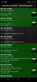

My neighbor brought over his obd2 reader and it shows a current P2610 code and these were the only 2 items (in the attached pic) that weren't "green". It did have what it called an "historic code" that said ECM/timing off. I unplugged the battery and reconnected it and the "emissions failure" and engine light went out, but I suspect it will return. It came and went before.

If the timing code is flagged as "historical", you might be okay in that the ECU isn't seeing the issue currently. Without going back to the other people's comments, I thought they called it a "relearn" that you have to do, not just a reset. Or maybe the ECU self-relearns over a few drive cycles and it's good now.

Yes. Relearn. I just need to know how to do that. I'm certain I'll get another service engine light and fault warning. It would come and go before.

Unless I have missed something in the prior 116 posts, you still have not identified the specific trouble code that keeps recurring. On a Honda, a common evaporative emissions code is P0457 which is often caused by a loose gas cap or a gas cap with a hardened rubber seal. This code can come and go if the seal is compromised.
You missed it in post #102, and the gas cap was the very first thing I checked.
