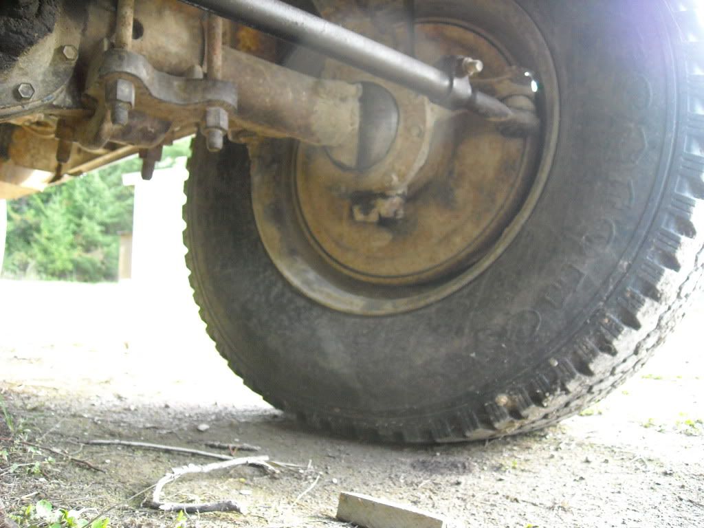

The only problem here is Rix is that is not nonsense, real Facts, real grease history, and interesting,
While this form of grease is rarely seen seldom used, it does have its applications,
And that would be, Sodium thickener is the strongest of the grease thickeners used, more oil can be contained in the grease
so Oil for the most part does all of the things you want grease to do, lubing, absorbing moisture, and so on
While the thickeners can add adhesion or cohesion properties,
So that is why this type of grease is used in "non oil tight power transmission devices"
IE the closed steering knuckle, and since it does such a good job in those axle, I stick it in other applications,
Only one problem with this stuff, not compatible with any other type of grease,
