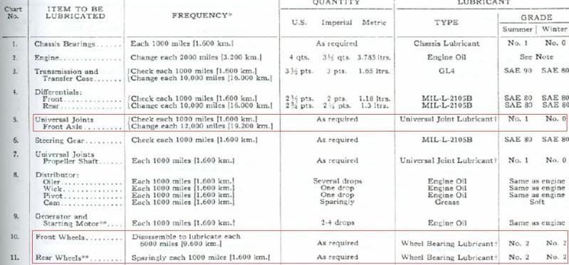

Part of the propblem with this situation is, that there is conflicting information in the older books as well,
Dodge books will, state in the same book, short fiber wheel bearing lube,
As well as multipurpose #2 grease,
Clearly two types of grease,
Now for Willies book, since on the page before he states that the wheel bearings are "filled" with a sodium grease, It is clear to me that since this is what the design of the axle dictates, lube flow thru spindle, that is what Jeep did,
Filled the wheel bearings with the same type and grade of grease,
Also one could say the wheel bearing #2 specification is for the 2wd model,
Since the page prior states to fill the wheel bearings in the application with the enclosed knuckle,
I know now why this has been such a confusing situation, the books do not always have clear information,

The main problem is that the Toyota FSM "recommends" a incompatible grease,.
The Jeep books may indicate a # 2 grease for the wheel bearings, but it is for the 2wd Clark Dispatcher axle,
It is just not very clear in the book,
Jeep does not recommend a incompatible base, warns you about it,
at the bottom of the page E-Rock posted,,,

Incompatible with your goop, yes. But it is completely compatible and identical to what was originally installed at the factory.
Umm, no. That chart is straight off the CJ2A/CJ3A lubrication page and is identical to the CJ3B/CJ5/CJ6 chart. It even has a picture right above the chart of a chassis that is CLEARLY 4wd with callout tags to the indicated lubrication locations.
Finally something you're right about. The Jeep manual says those points are filled with sodium grease from the factory and recommends sodium grease be used to avoid incompatibility.
The Toyota manuals for solid front axle vehicles over several decades, on the other hand, recommend a lithium-base grease. Owners and shops have been using that recommendation for several decades with no ill effects. But you still believe that Toyota put a sodium-base grease in there at the factory?
