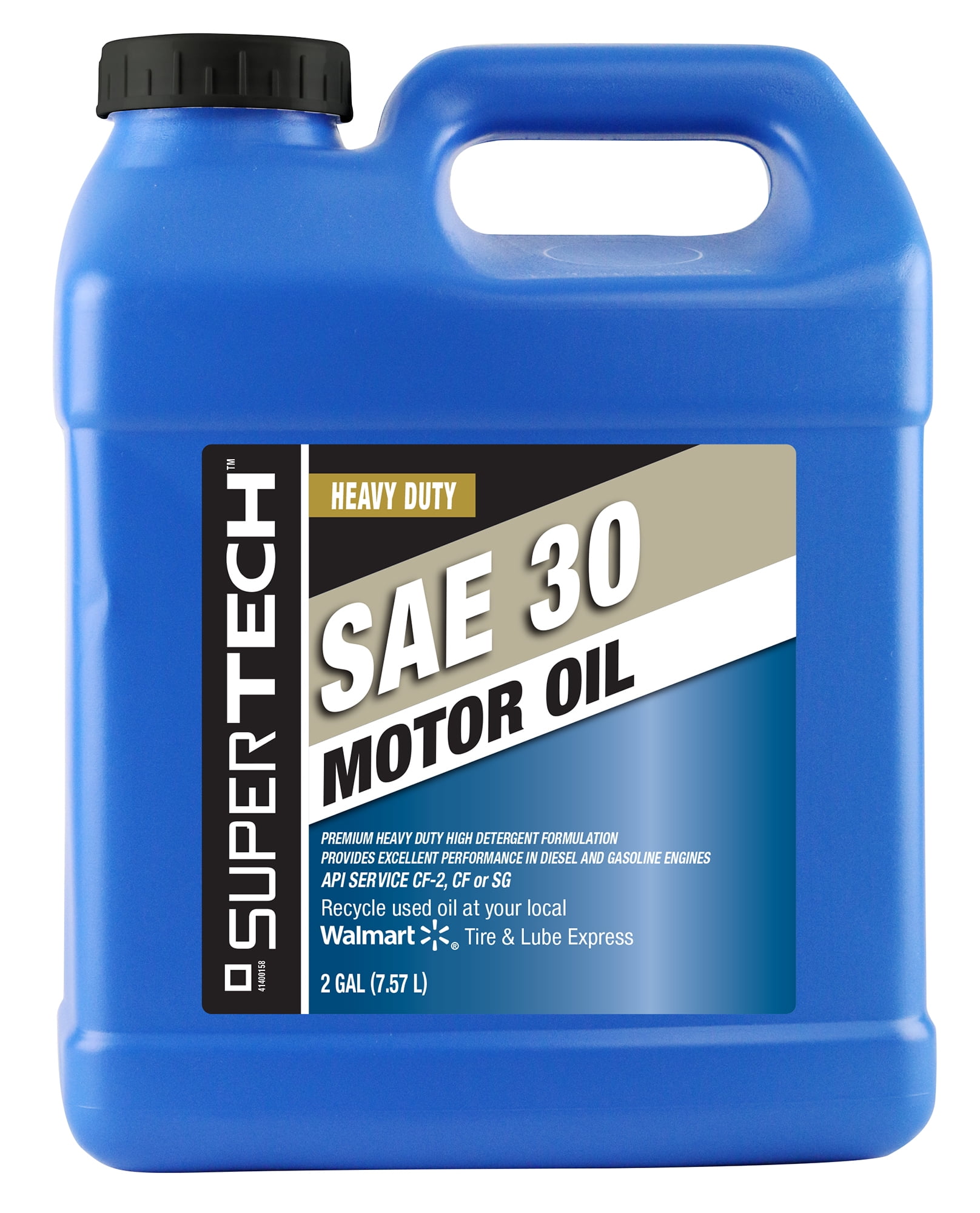

There's something wrong with that copy. The bottle is clearly their regular SAE 30 for gasoline engines only. They seemed to have mixed up the copy that's supposed to be for the 30-CF.
I believe this is what the OP has found on shelves. They show two versions of the label, although it looks like the same type of oil.
https://www.walmart.com/ip/Super-Tech-Heavy-Duty-SAE-30-Motor-Oil-2-Gallons/16474404
[Linked Image]
[Linked Image]
An SG 30wt oil would be fine for you bug. That was the standard around that time. I question using an SN oil because a lot of good stuff has been taken out of SN's that your Bug would need.

That will be perfectly suitable. If it were CF-2 only, that would be another matter. CF/SG is fine.

Both API SG and CF are outdated and I don't believe the API will license any oil claiming to meet just those. I guess it's kind of like using something claiming to meet Dexron-III standards. It may very well be compliant, but the API sure as heck isn't going to be involved with it.
