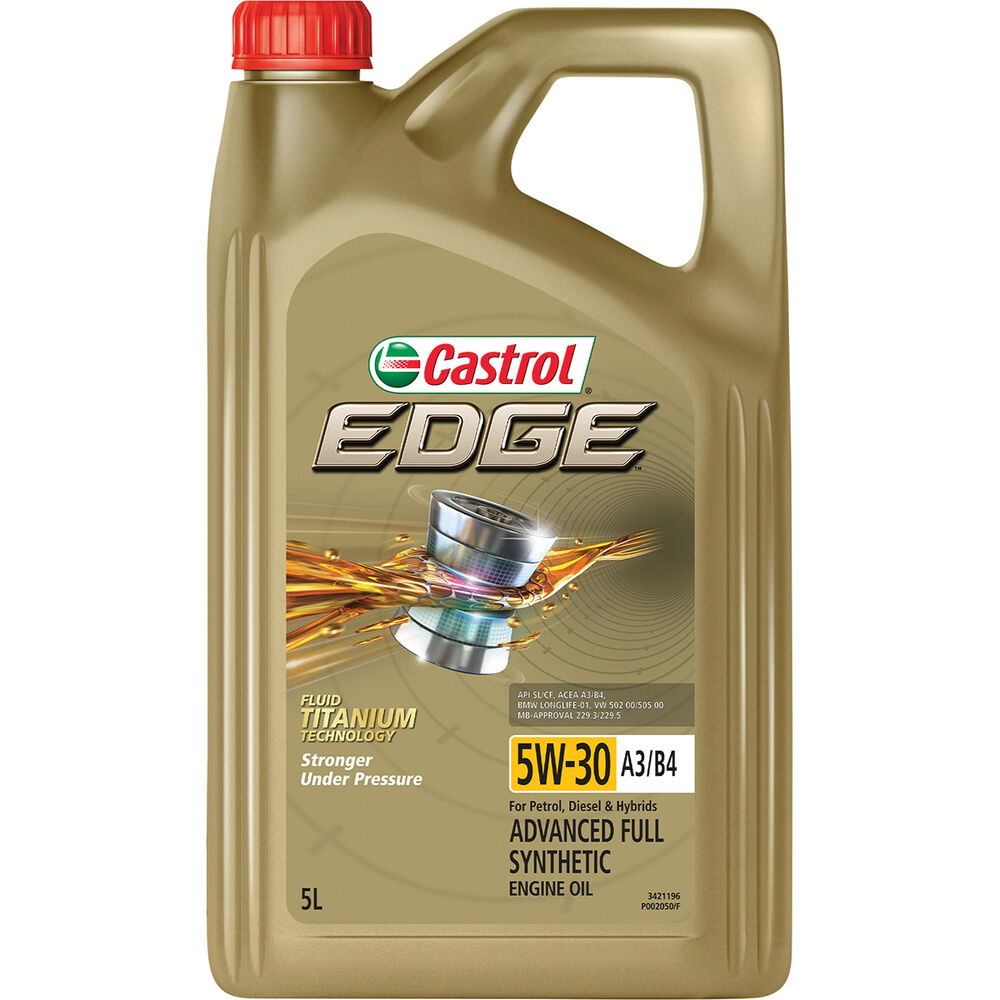

None of our oils of any brand carry API stars or donut, they just list the specs how they want on the bottle.
Here is a link to Castrol Edge, you can see the same thing.
https://www.supercheapauto.com.au/p/castrol-castrol-edge-engine-oil-5w30-5-litre/299206.html
The exception may be Mobil 1 as I believe that’s fully imported as a complete bottled product, which is why it costs about $100 for 5L, and too expensive for me.

Same with Valvoline, same with Castrol Edge, same with my containers of Shell Helix Ultra (aka Pennzoil Platinum pureplus).
