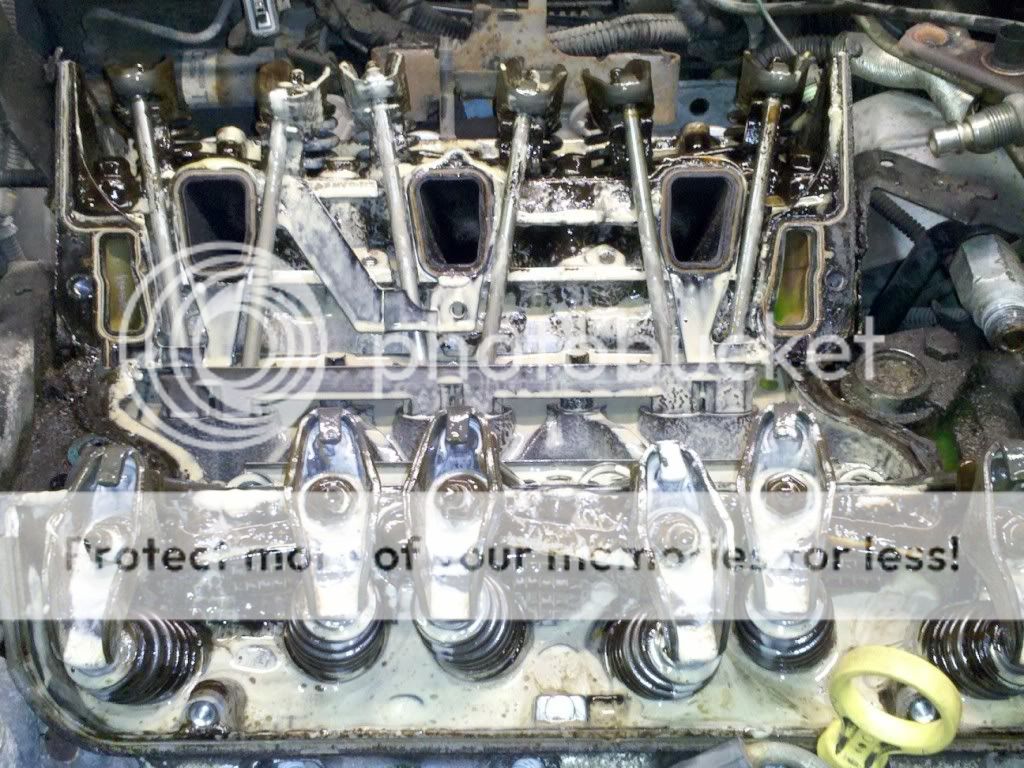

looks good and clean! any sludge when you replaced the img?
Yes, some....
The engine came from a customer who couldn't afford to have the IMG replaced. I bought the car off of him and slowly went through it. New rings, bearings and had the heads re-built. Luckily the engine wasn't damaged, in spite of having 9qts of coolant and oil in the crankcase (instead of 4.25qts). While I did cut a few corners, I'm pretty confident it'll last as long as or outlast the car.

As to why I didn't just do a head gasket job or rebuild the existing engine? Well, you know of the common GM piston slap issue? This engine had piston slap on steroids... And not just cold either. It was also leaking coolant at the timing cover and oil in several spots. To remedy all of it's issues would have required more time and money than I could cover in the relatively short amount of time she would be gone. Doing it the way I elected to may have cost more, but due to the time factor, I could afford it by spreading it out.

And since I'm typing, I'd like to take a moment to recognize the efforts of my (considerably) better half. Bless her heart, she's not afraid to jump in and get dirty. She's helped me off and on throughout the build; She helps me lug things around the garage, clean stuff up and even helped on the engine assembly. She was even there when I wanted to completely disassemble the lifters and get the varnish and mayonnaise out of them. Lots of tedious scrubbing and assembly. Thank you bunny....
