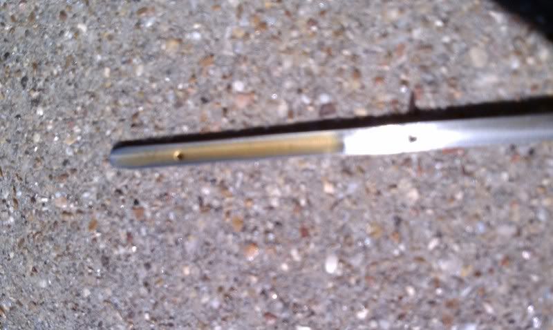

Here are some pics...
Oil at 23K on the dipstick.
