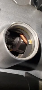

New rings, new valve train, I assume those are the primary sources of the elevated iron, one top of the heard is a brass / copper pipe that I assume carries oil one possible source of the elevated copper, could also be new sealants.

That’s an ass ton of Cooper in there, in my opinion.
I’m shocked to see that cooper pipe being so close to the camshaft. 😳😬🫣
Manufacturers sure do make interesting design decisions. 🤨🤦🏻‍♂️

The proximity is an illusion, 2d flattening in a photo, I also see it in the photo, but in person where you get some depth there is plenty of clearance, the MX-5 motor is mostly based on the standard Mazda 2.0L skyactive, teardown here shows a better view, some changes to the crank head and cams for higher RPM (7,200) and about 30 HP
Looks to me like the pipes carry oil to the CAM journals. but I could be mistaken. there is also an oil to coolant heat exchanger in the system, material unknown but copper, or copper alloy like brass is a possibility.
Copper is not a metal I have ever had come up in a UOA, I assumed it was leaching from one of the new parts, any reason I should be concerned?
Edit, speculation here that these tube may in fact spray the cam lobes, https://bobistheoilguy.com/forums/t...kyactiv-oil-control-valve-oil-seepage.316622/

@RavenTai — maybe mine is aged and discolored or it’s a different alloy all together but I definitely don’t remember seeing any tubes looking down into the filler hole on my 2014 Mazda 3’s 2.0L Skyactiv. Must be a new design for the updated engines.
