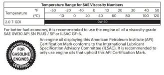

In the owners manual they show 0w30 as the ONLY correct grade.

Lol, I would love to see them run a test that actually measures the winter rating of an oil. This isn't a $30 Blackstone UOA.
Besides, SAE J300 allows the winter rating to slip one grade under use so the whole notion that a warranty would be predicated on a specific winter rating is a bit ridiculous.
Notice the Owner's manual says recommended, that's because all grade recommendations are... recommendations. No warranty is predicated on grade. It's not the only "correct" grade.

They show 0W30 as the "recommended" grade. And why is there a concern with the zero winter rating? They are both 30 grade oils.

I'd say that wording is unambiguous.
Yes, but some people apparently have a difficult time comprehending the totality of what is written and extrapolate it to something unwarranted.
I agree - in the case of "XYZ car company recommends ABC oil viscosity." which is quite different that what is written in this one.
On the other hand, in light of this iron-clad requirement how should the poster interpret where it says "however, higher viscosity engine oils are required for satisfactory lubrication in hot weather?"
If you note it's the only statement in the whole thing that actually uses the word "required."
If you note it's actually the only statement in the whole thing that actually uses the word "required."
Yep. I've seen that same ambiguous language on other owner's manual post w/r to oil. So as is said over and over....go thicker not thinner and you will be fine.
