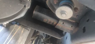

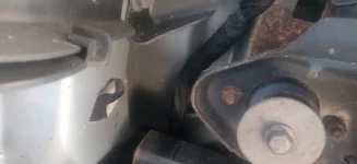

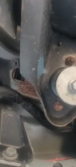

Here are some pics I took today behind the left, front tire, at the left, front cab corner. The truck has never been undercoated with anything and has Husky mudflaps all around. The truck has seen three PA winters with salt and calcium on our local roads. Sorry about the photo quality. . . it was hot and I was in a hurry to get in the truck!

Thanks Robster. Maybe it's just the angle of your pics, but those don't look like the same design as mine.
To sum this thread up, I am betting that the truck was driven often on gravel roads like shown below. The cab design results in debris thrown up from the front wheels, sand blasting paint and e coat off. IMO, paint warranties won't cover this just like they would not cover a stone chip to your hood. If he checks and maintains the area several times a year, he should be fine. Paint, oil, grease, or whatever coating he chooses should suffice as long as he keeps up with it. In The Critic's picture, you can see they coated the similar area for abrasion. JTK may not have the abrasion issues encountered in the past. A plastic debris diverter could be diy'ed to prevent further abrasion if needed. Thanks goes to JTK to alert others to keep an eye on this.
There is a slight possibility that the mfg. might have covered dealer repair the same way member Gregk24 had rust issues fixed on his his Honda door interior. Maybe they have a TSB on this and a procedure. JTK can do as good, or better IMO.
