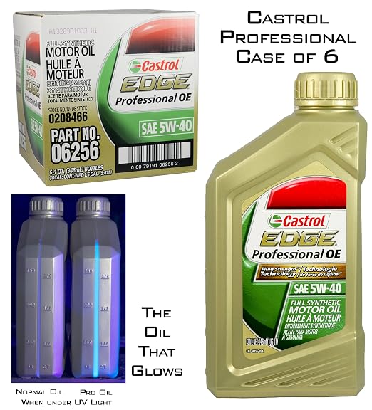

I've never heard of FF oils having the UV-light visible dye already there, though Castrol OE oils for dealerships have it:
Technicians can simply add a little UV dye separately if they want to track down a small leak so it doesn't have to be in the oil in the first place.
Moly does darken the oil by itself, although not green.
Mazda Genuine Motor Oil has a ton of moly in it (~700 ppm) and is black, not green.
Liqui Moly MOS2 additive is black, and can be added to break-in oil if changing it out early and you want the benefits during break-in.
