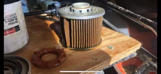

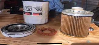

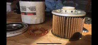

Hi, guys! My latest UOA on my ‘07 Grand Marquis LS. Wear metals stayed consistent, but they noticed some extra fuel this time around. Is this anything I should worry about? Blackstone does not seem to think I should be. Thanks, for any info!
Also, if anyone is interested: Here is the oil filter from the same run, cut open. FL820S.

I used to run that same engine for 15,000 miles on one oil filter and 5w20 oil. Insolubles went down from 0.4 to 0.3 to 0.2 if I'm remembering correctly. Cut open the filter, it looked just like this one. These were all highway miles at 65-75 mph. It had a lifter tick that quieted down with one run of Auto-RX....one of the old cleaning products from over a decade ago.

Yep, youve been dumping perfectly good oil.
Those engines are legendary for longevity, minimal wear and being easy on oil.
Yours looks like no exception by your UOAs.
I’d probably run 8to10k if it were me. What your doing certainly isn’t hurting anything though.
