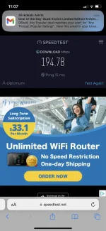

So for example for me, I'm paying for 300 mbps. here is 15 feet from my router:
Versus 40 feet but still in the house same floor:
Versus driveway maybe 50 feet away:
