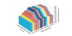

Yes as i said some(most EU) modern cars use ECU actuated thermostats, warm water does not mean the entire engine is warm, thats why you cant floor an engine only after the thermostat has opened.
The newer cars that use high temp thermostats let the engine warm up till 110c / 230f. This helps heatsoaking the engine/head etc.. faster, because they have an oil/to water heat exchanger this also helps heating up the oil faster by using the 110c / 230f hot water.
So yes for short trips colder/climate a higher opening thermostat might defintatly see some improvements, to heat up the valve cover etc...
The time that it takes before an entire engine is up to temp might be 2 to 3 times as long compared to when the thermostat reaches temp.
The car we are using is a ''high performance'' car so to let it run hotter at all times is not benificial, because a hotter engine is less powerfull.
There are also colder thermostats available, that would be better if this was for example a track car only. However because its also used for daily use this is not recommendable.
These are the problems where manufacturers are also coping with, especially with high performance vehicles.
Emission laws require extremely fast warm up, however the engine can not run too warm, and with fast cars the coolant system still has to have enough capicity to deal with track conditions. Especially turbo cars suffer from this.
Hence why an MAP controlled thermostat is ideal, however retrofitting this to an older car is difficult/expensive.

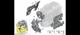

Yeah offcourse there main purpose was to reduce costs and engine weight, however faster warm up is definitaly also increased by this because the plastic houses dont heat soak as much as allu does and so the heat is kept in the oil/into the engine.
With my bmw i drove without the undercover for a while due to an oil leak that i was wokring on to find, i noticed that the engine cooled down much faster and warmup took much longer. How did i notice this: my car drives on LPG fuel, (common in holland) the car switches over from gasoline to lpg once the engine coolant has reached 40c in the ecu input. Without the cover this took much longer/i was much further from home before this happened.
Also the engine noise was much louder outside the car and also a little inside the car.
The top covers on some of the newest generation cars are not made from plastic any more but from some type of PU like foam material, also for valve train sound insulation and heat retention/faster warm up.
At the other picture you can see where bmw puts insulation on there newest engines, they claim that these engines can maintain heat for up tot 36 hours.
