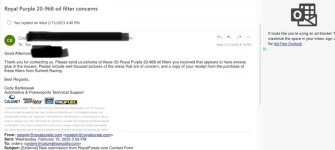

i'm impressed at how fast Royal Purple customer service has contacted me. they asked for pictures and order number from Summit. will keep everyone updated.
