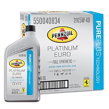

How is PU a defunct oil? Changing the name doesn't change their approach or product tiering. If you have a flat tire and simply rotate the tires, does that fix your flat?
And, still on about phantom products? We should have a contest here to see how many posters can get pictures of the products in the wild, without setting foot in a dealership or a SOPUS distributor or getting it from an online reseller or shipped by Shell themselves.
If we had something other than stock photos, because, as I indicate, these products are next to impossible to find, we could compare bar code numbers on the back of the bottle. For instance, despite Quaker State's website, when Defy was introduced, it replaced QSED and took over its bar codes.

Correct. The 2013 PDS (which I call the "current" version, as it was the last PDS for the product and the last one to have NOACK listed) was the GTL-based Pennzoil Ultra 5w-40, which was the stuff I bought for the M5. It had the extremely low 6.8% NOACK figure.
There was:
1. The original Platinum Euro 5w-40 (Group III)
API SM
100C: 13.1 cSt
40C: 74.4 cSt
Flash: 420F (215.5C)
VI: 179
Pour: -39C
CCS: Just max listed at 6,600cP
HTHS: 3.68cP
NOACK: 11%
2. The Ultra Euro 5w-40 (2013, GTL)
API SN
100C: 13.2 cSt
40C: 80.7cSt
Flash: 420F(215.5C)
VI: 166
Pour: -45C
CCS: 6,200cP
HTHS: 3.88cP
NOACK: 6.8%
3. The Platinum Euro 5w-40 (2015, GTL)
API SN
100C: 13.3 cSt
40C: 80.8cSt
Flash: 215C
VI: 167
CCS: 6,300cP
MRV: 19,500cP
As QP noted, #2 and #3 are extremely similar. They may even be the same oil. But since SOPennzoil UltraS no longer lists NOACK or HTHS on the PDS and didn't list MRV on the previous ones, it is hard to say for sure.
