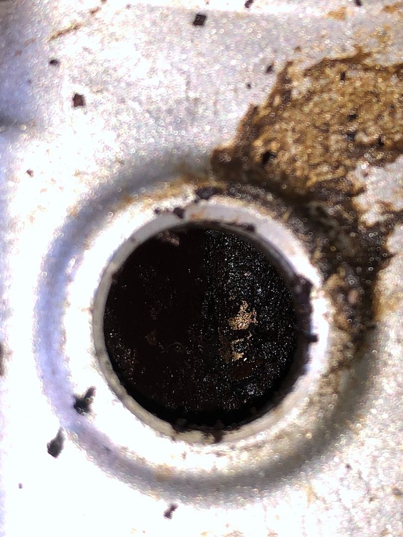

Has to burning it as there are zero leaks on the driveway.
I just replaced the PCV valve with one from
NAPA and I have an OEM valve on its way from Amazon. When I replaced the pcv valve it was pretty dirty below it and this is what got me to thinking about the Kreen treatment. I've seen where it cleans stuff up pretty well and gets good reviews.
Another option would be the Valvoline Restore
This is what it looked like under the PCV valve....

Holy smokes, I wouldn't do anything to that engine other than short interval changes. That much coked up carbon is going to kill it if you shock it.

Is this picture right when you changed the PCV or how much later?
There may also be a lot of this in the hose to the PCV and it would be my suggestion you change that out as well.

Right when I changed it. I had already gotten the brittle gasket out
Are you sure what you're seeing through the fill hole is sludge? My old 1MZ-FE engine has a baffle under the fill hole that has a black gritty coating that was there from the factory. If you work hard enough at it you can scrape it off as your picture shows. But it is normal and has fooled a lot of people into thinking their engine has "sludge" when in fact it has nothing of the sort. With the baffle in the way of seeing the camshaft and head you can't tell anything unless you pull the cover and look.
I'm not, it's why I'm asking. If this consumption is normal I'll stick with the PP. I may try the Kreen just to try and clean stuff like this up and I haven't seen any documentation that it hurts anything

I would try poking it with a clean object. You will know right away if it's sludge or the baffle.
And sorry, my mistake. I thought your picture was down the fill hole not the PCV hole. My comments and picture do not apply to that.
The PCV is connected to a baffle/passageway system in the valve cover. You will see deposits there, they really can't be removed by any cleaning solvent or additive to the oil. The only way to get rid of them is to remove the cover and have it cleaned with strong solvents that wash through the passages in the cover. Generally those passages are covered by a plate that is riveted in place and I have heard of people grinding the rivets off and somehow re-attaching the baffle plate. But I would say that what you're seeing in your picture is normal, this is a cooler spot in the cover and a prime location for deposits to form. Like I said I don't think there is any way an additive is going to wash this area as it is designed to keep the oil from migrating into the PCV valve.
